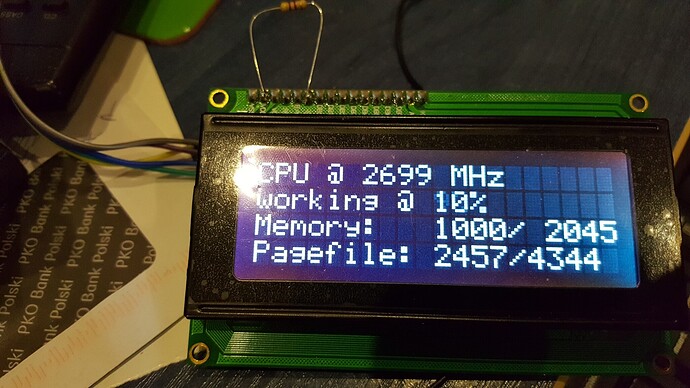

I figured out what the baud rate was and what I should change it to (which seems to be 19200 in my case).
It's working fine for the first time right now.
Thanks again Bill, I owe the success to you. If you're ever in Romania, I need to buy you a beer or 10.

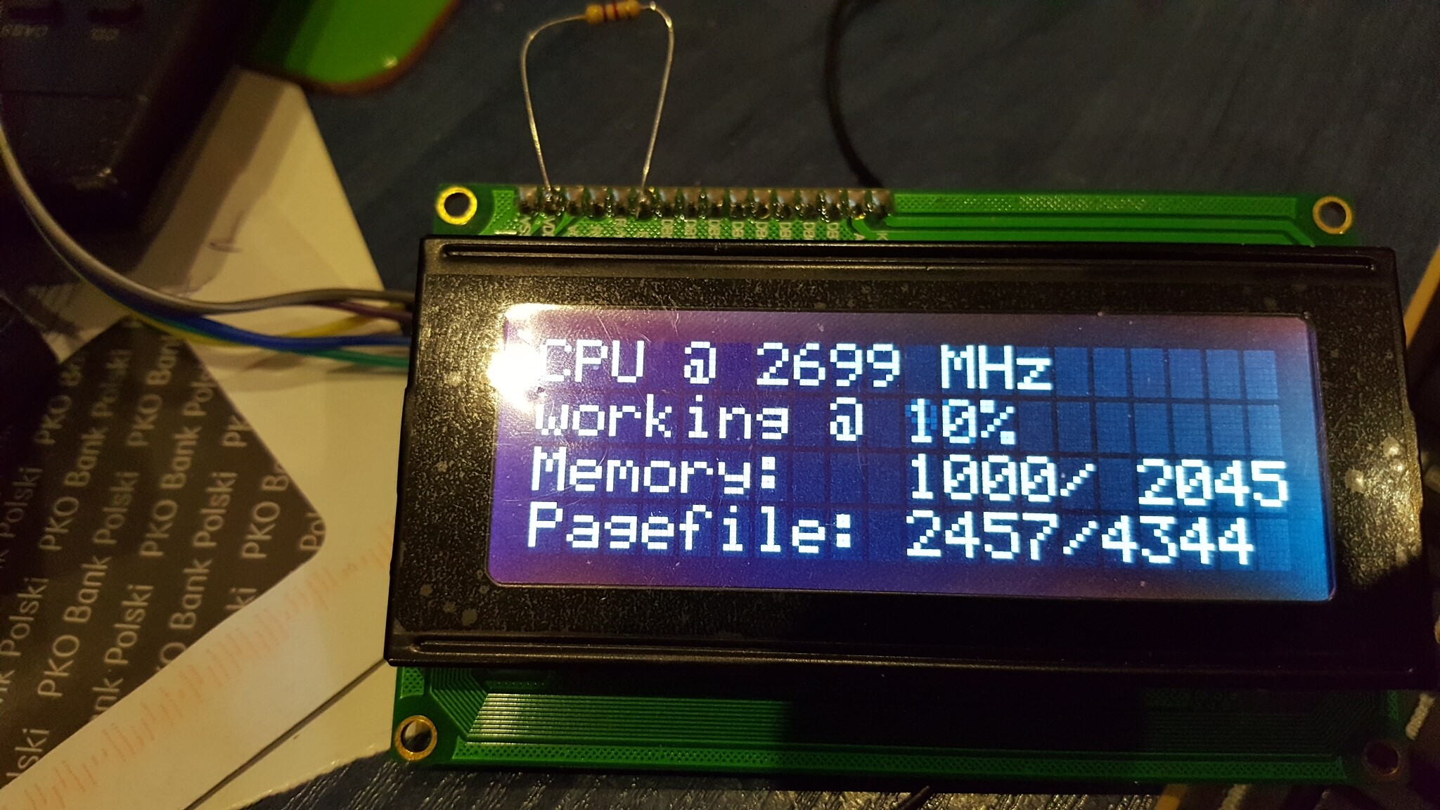

Hi. I am trying to run a sketch of post 7 to arduino micro. Lcd smartie gives me garbage on the display. The same code for arduino nano works correctly. What may be the problem? I used the library newliquidcrystal. The file LCD.h "void command (uint8_t value);" I made a non-private and compiled without problem.
Googling, testing and have a little step forward. Sometimes it runs well but after restart again displays garbage. See attachments. I add delay 10000 after serial.begin()
