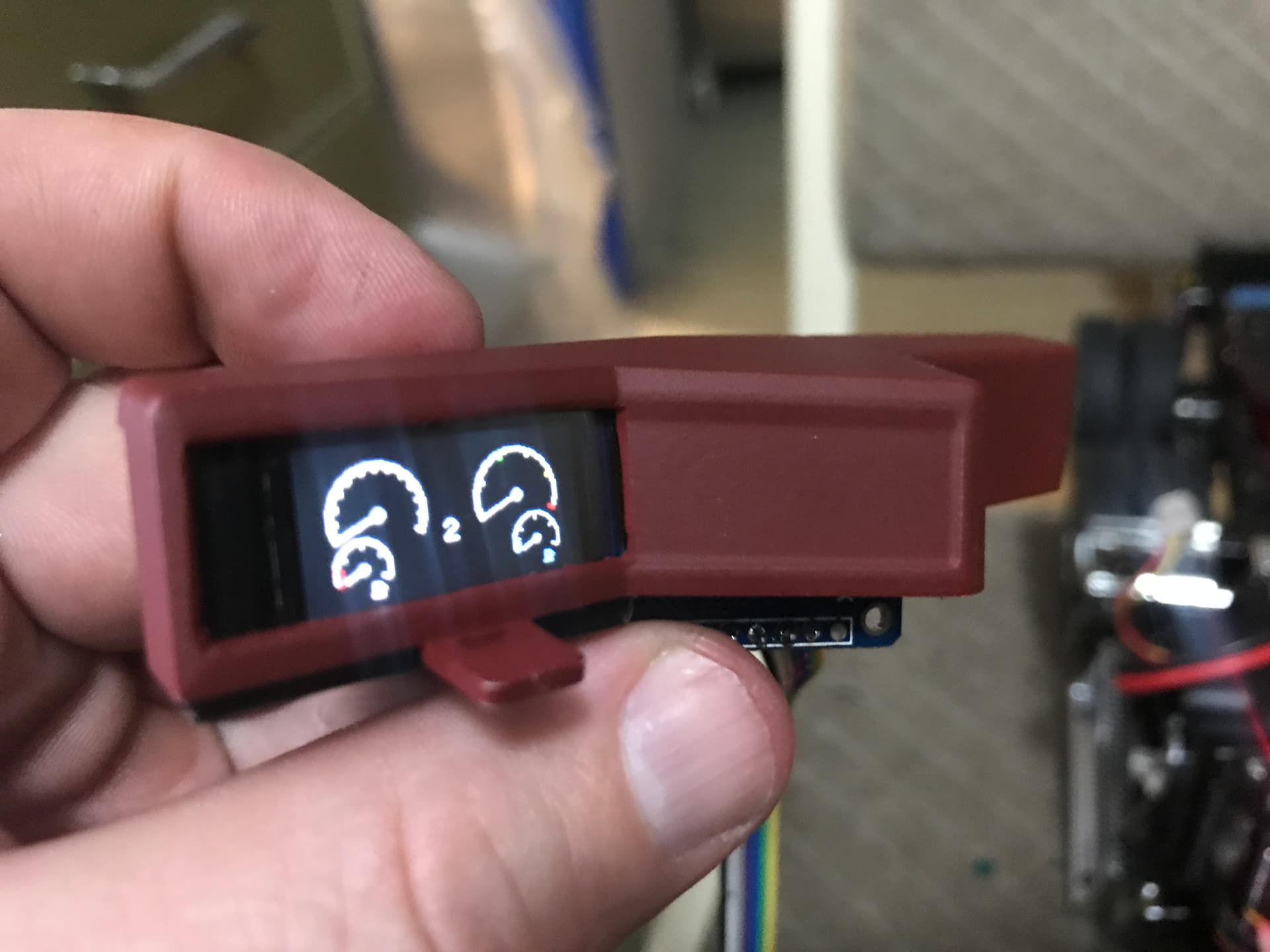

I have just replaced my 0.9" 160x80 LCD screen and all colours/black and white are now inversed.
AFAIK it's the same type of screen, looks identical.
Some searching here suggests there's a way to invert the colours, but I don't know how to go about it.

What I can't fathom is the previous display was fine (but failed as my VCC probably went too high) whereas this identical looking screen is colour inverted.
Should look like this:
but new display shows white as black, green as red, blue as yellow etc ie all are opposite to what they should be.

If I were to hazard a guess, you could try to uncomment the GREENTAB line instead of the REDTAB one. I have a feeling this might give some insight (and if you're very lucky, even solve the issue).
The root cause of the problem is likely a small difference in how the display memory is mapped between your old screen and the new one. Telling the sketch to use the correct code for your new display should solve the issue.

Tried using the various "Greentab", "Redtab" etc options but no change.
I did come across another similar (old) thread with this issue, and this command was suggested:
I added the line tft.invertDisplay(1);
from that post, however it needed an underscore prior to make it work.
It's added here in "dashboard.cpp" at line 16:

_tft.invertDisplay(1); // Dave mod to try invert display pixel colours, 0 = normal, 1 = inverted SUCCESS!

It has inversed all pixel colours and the screen now looks as it should, black screen with white or (correctly) coloured graphics.
Thanks to all that commented here, hope this helps others out.
