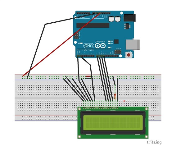

I have connected Lcd ,adruino and breadboard but the lcd display not showing the text that is wrote on the code of arduino
Welcome to the forum
The photo shows that you have multiple LCD pins connected together by the breadboard and some pins that are not connected to anything. Do you understand how the connections of a breadboard work ?

Why are you using pins 0 and 1, they are the programming pins and should be avoided.
Can you please post your program.
Can we please have a circuit diagram?
An image of a hand drawn schematic will be fine, include ALL power supplies, component names and pin labels.
