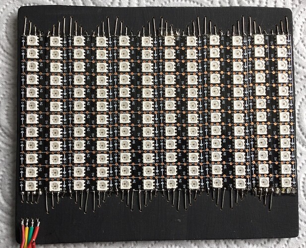

Regarding LED stripes (for example WS8212B): Let's say I would like to do a square, it will not be possible unless I cut it in pieces. How would I reconnect those individual pieces? Solder? jumper wires?
Yes wire and solder is good.
However you can get several matrix displays based on these chips, ready built. Just google
ws2812 matrix
and you will see lots of examples.
This is one I have used:-
https://www.ebay.co.uk/itm/8x8-64-LED-Matrix-WS2812-LED-5050-RGB-Full-Color-Driver-Board-For-Arduino-F-T5H3/283114378205
This is a picture of a matrix I made using a slightly different sort of LED strip that has 4 connections and not 3 but the idea is the same.
The solid wires just go horizontally at the back of the board.
Amazonasmann:
Typically these strips are designed to be cut [they even, usually, have a little "scissors" icon that shows where to cut]. This will leave a set of copper pads on each side of the cut. And, yes, the best way is to solder wires to these pads. Just reconnect it as it was before the cut.
