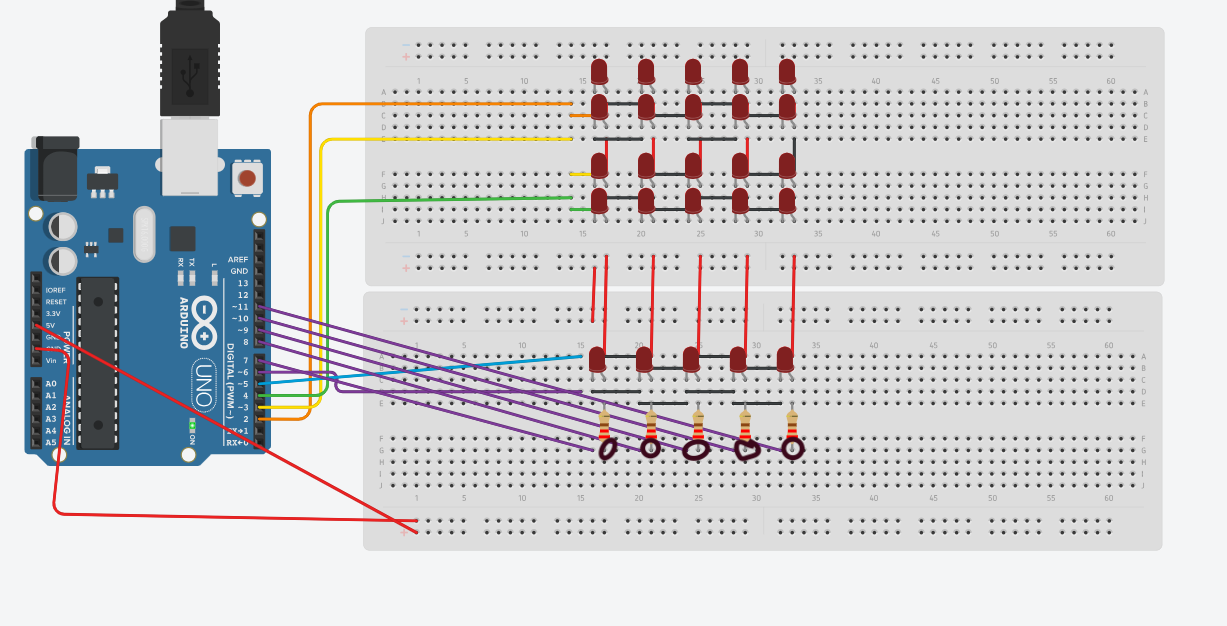

Good evening. I am seeking assistance with this activity. I am uncertain if my wiring is correct because when I run the simulation, some of the LEDs do not turn on. I also attempted to place the wire at the end of each resistor and connect it to pins 7 through 11, but it did not work either.
Yes, your wiring is incorrect.
what part is incorrect? can i ask for guidance?
Pins 7 to 11 are not connected to any other components.
The resistors are incorrectly placed and their values are too low. I would recommend 820R
And I think you need a jumper connecting the +V and _V buses at these points red marked.
Also your first 2 rows of LEDs are shorted together.

i tried to adjust my leds below so that my wires are not connected in positive rail of the breadboard and tried to connect the wires below the end of each resistor, but it did not run.
No, they are not needed. The buses are not being used. @ch8 you can remove the wires from the Uno ground pins to the breadboard buses, and the wires between the breadboard buses. None are needed.

Your new diagram is different but not closer to being correct. EDIT: I changed my mind. It is further from correct than the previous diagram.
I think maybe you do not understand which sets of holes in the breadboard are connected together and which are not.

Thank you. I have attempted the activity again. To be honest, I am confused because it is quite different from what my professor taught.

P.S. Your resistors (see circled parts in the diagram) are not connected to anything on one end. Maybe you confused the orientation of the purple wires, which are also not connected to anything. I assume the resistors and the wires are supposed to be connected.
I already turn on the 2 rows in 2nd breadboard, but the 3 rows above doesn't turn on. Can you help me? In the right side is my draft code
