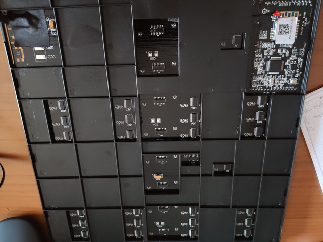

hi, i'm searching a battery powered display (about 25X25 cm) that i can control with the smartphone.
At first, i searched a display based on led ws2812 controlled via arduino, but only one led assorbe about 50/60 mA and if i use a 32x32 pixels display it consum a lot.
After some research i find led matrix 64x64 pixels that i can power with a 5 Vdc powerbank.
i attach some image:
After some tests, if i power it with a white image at the maximun of the luminosity, it assorbe only 1.58A!
i don't know a lot of elettronics but how can it possible ?
someone know something about this display?

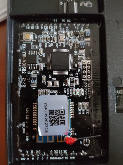

another problem is that the comunication with the smartphone use WIFI and not bluetooth, why?
bluetooth is not enough powerful to transmit the image to the display?
i hope that someone can help me clear my head.
Thanks

My guess would be that the current consumption is less than you expected because this is a multiplexed display, with 1:16 or 1:32 duty cycle. So any individual led is on for only 6.25% or 3.125% of the time, even when they appear to all be on at the same time.

Perfect, i search multiplexed display, practically the leds are turn on and off at high frequency that seems they are always on, correct?
i can create something similar with arduino and 64x64 pixels ?

A display made from ws2812 is not multiplexed. Because of this, it uses much more current, and it is much much brighter. A 64x64 ws2812 panel would be too bright to look at, like the sun!
Other panels are made which can be used with Arduino but they are not for beginners.

Most panels not made with ws2812 are multiplexed, yes.
Individual LEDs are not "multiplexed" or "non-multiplexed". It is the circuit design of the panel that makes them multiplexed.
I don't know exactly what you mean by "efficient". I suspect you mean low power, which is not the same. Lower power panels will generally be less bright. Higher power panels will be more bright.
