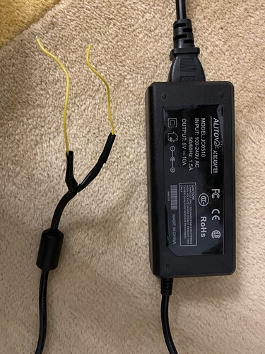

I am making a LED matrix 64x24 where there is 64 LED in every strip and there are 24 strips. The LED strip I am using is called WS2812B; I connected the 24 strips by soldering them together, and have added five reinjection points every five meters of length (since the current decreases by 0.06 A/RGB LED). I am using Arduino Mega 2560 to control the pixels and have used an external power supply that gives 5v and 10 amps (max input for this type of LEDs is 5v). This external power supply is connected to a breadboard that connects the Arduino and LED strips together. The power supply was originally a laptop charger which is why I have cut the end of this adapter and stripped the ground and live wires to be able to connect them to the breadboard. I added to my breadboard a resistor (220 ohms) and a capacitor (100 micro-Farads) to ensure that my LEDs won’t burn out. My problem is that my LED matrix wont light up, not only that but also when I plug in the power supply smoke starts coming out of the breadboard. After looking closers turns out that some enclosures of my wires are melting, and my guess is that my breadboard can’t handle more than 1amp. So, what would you recommend me to do to overcome this problem? and is my deduction of the problem being related to the breadboard right? If so, I am thinking of removing the breadboard and connecting everything by soldering but don’t know how to include the capacitor and resistor…

So as advised in so many discussions here - for anything more than half an Amp, do not use a "solderless breadboard".
Solder proper connections. Including the capacitor and resistor (that is after all, how they are supposed to be connected into a circuit).
Good start but you need power injection points a lot more than every 5m. Probably every 1m will be OK, at the very least each end and the middle of every strip. Take each pair of wires back to the PSU, not a daisy chain. The wires coming out of that PSU don't look thick enough for 10A.
Your drawing does not show the power injection, what else does it not show?
As Paul says, you can't use breadboard for anything high power, you need thick wires and soldered connections.
I don't know what you mean about the capacitor and the resistor, solder them in place. You will have to ask a clearer question if that's not the answer you are looking for.
