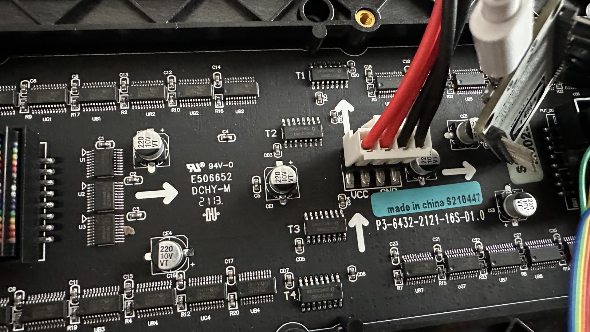

Can you post a photo of the back side of the matrix so that the inscriptions can be seen?
Have you tried using other libraries for RGB matrices, such as SmartMatrix , ESP32-HUB75-MatrixPanel-DMA or Protomatter? If you have a RP2040 type board, you can also try DMD_STM32 library
Here is the back side.
I will try the mentioned libraries!

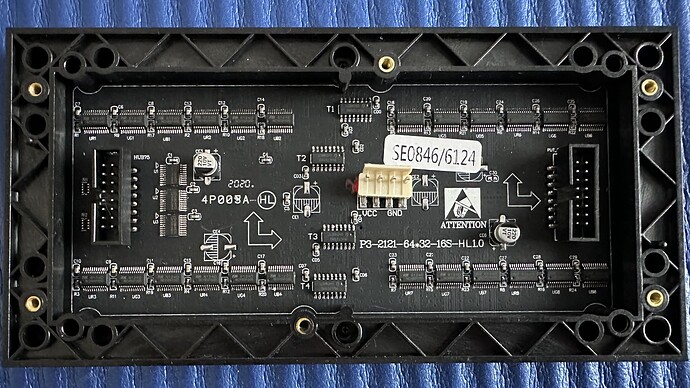

Here is the currect panel I am testing with:
Same panel, zoomed in...
(sorry, I can only use one embedded photo per post)
..and this one is the first panel I was using and testing:
It behaved the same way.

Could you inform what the names of the chips U1-U2, UG... and T1-T4 on your matrix?
My current testing panel (P3-2121-64x32-16S-D1.0):
"U" rows are: CHIPONE ICN2037BP B47271MA
"T" chips are: RUC7258D OWC20140
The other panel (P3-2121-64x32-16S-HL1.0) has:
"U": 6124D NCH591000
"T": RUC7258D OAD18871
