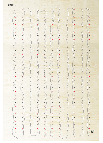

I'm new to the Arduino community but already love the endless possibilities and nice projects I've encountered so far. After walking through many tutorials, I'm currently planning my first own project where I could need some advice/guidance. I do have experience in programming, however, the whole hardware part is rather new to me.
The Project
There is this app that controls an 11x18 LED matrix attached to a board (see attachment). Since the original hardware isn’t available all over Europe, I want to build it myself since I also consider it as a very nice beginner project for me. The main output is this LED matrix with 188 pixels with 20cm distance between each pixel. So overall, the LED strip will be ~40m long. The app sends a message via Bluetooth defining what pixels should be ON/OFF. Usually, there are not more than 20 pixels ON at the same time.

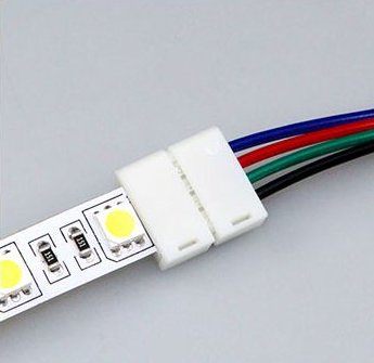

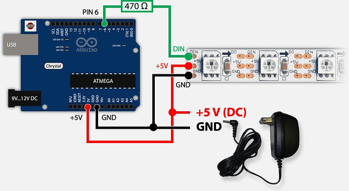

I have an Arduino UNO with an Adafruit Bluefruit LE UART Friend to receive the message. As an LED strip, I’m considering using a WS2801 (or something similar – see questions below). I’ve read many posts already and the setup attached seems to be best practice (BT module missing of course). Some people also add a 1000uF capacitor. I'll add 20cm connecters between each LED (see attachment).

What is suggested is using a ready-to-use "buck" converter. Choose one rated well beyond the calculated requirement of the LEDs. You do not "build" power supplies in this context. Choosing the correct components will not "damage" your "power station".
Please explain clearly exactly which LEDs you propose to use in this array so we can figure just how much current it will require. You seem to have mentioned quite a number of different options. The last picture shows a 12 V RGB strip where all LEDs are the same colour.

Well now, these chains which presumably incorporate WS2811 chips (separate from the LEDs visible in the encapsulation) will each draw a minimum of 50 mA when dark and about 2.8 Amps at full white brightness. Four of them, about 11 Amps maximum. What is the rating of your "buck" converter?
You need to connect 5 V power to both ends of each chain to avoid significant voltage drop along the chain (at high brightness). "Connecting power" of course always means both 5 V and ground.
And indeed, you connect that 5 V power to the "5V" pin on your Arduino. A Nano is far more practical than a UNO (and generally cheaper) - reliably connecting to the socket headers of a UNO is difficult - you would really need to insert pin header strips and solder to those headers.
