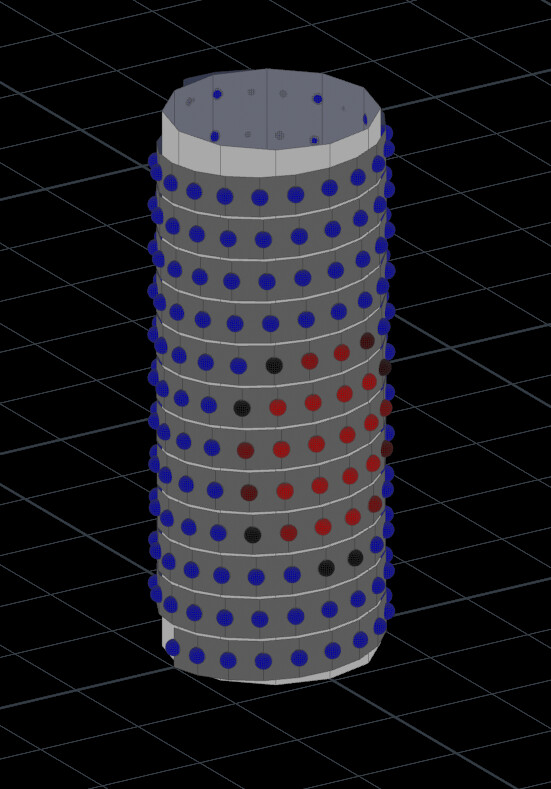

here is a mockup of my idea:
The map is 2D, the object is 3D, I think we are both in agreement. I was just curious if there is a library or an optimal approach for mapping a configuration like this since there isnt a distinct seperation between rows, it may be something involving interpolation, or maybe I am overthinking it. I was just curious if there are examples of how mapping this sort of configuration could be tackled.

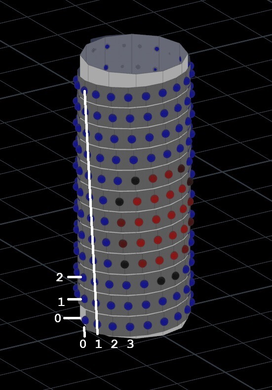

thank you for your time, this is the first approach I was thinking of, I was just thinking it might not be ideal since when the row ends it has shifted up by one row, so there will be a diagonal distortion in the coordinate space, which is why I was curious about approaches with blending/mixing in some way, but I think this approach makes sense to start with.
Measure the slope of the vertical and horizontal offset and factor that into the equation.

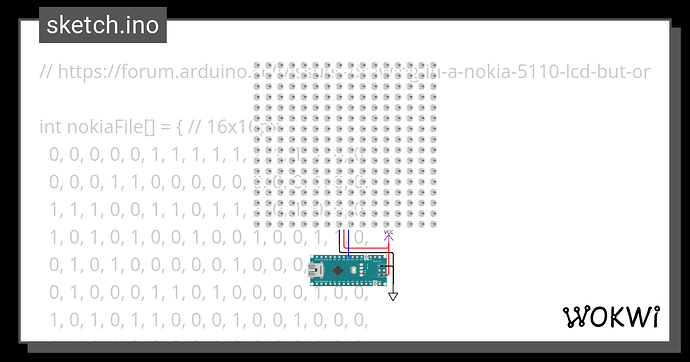

Aha!
I made a simulation for a user who went through "learning the math" - upside down, alternating rows, backwards - but eventually got to an understanding. Here's the sim, contains the link to the topic.

The LED strip in the original idea would have been diagonal, not horizontal. And in most configurations the LEDs wouldn't line up vertically either, so you'd end up with both diagonal "rows" and diagonal "columns".
