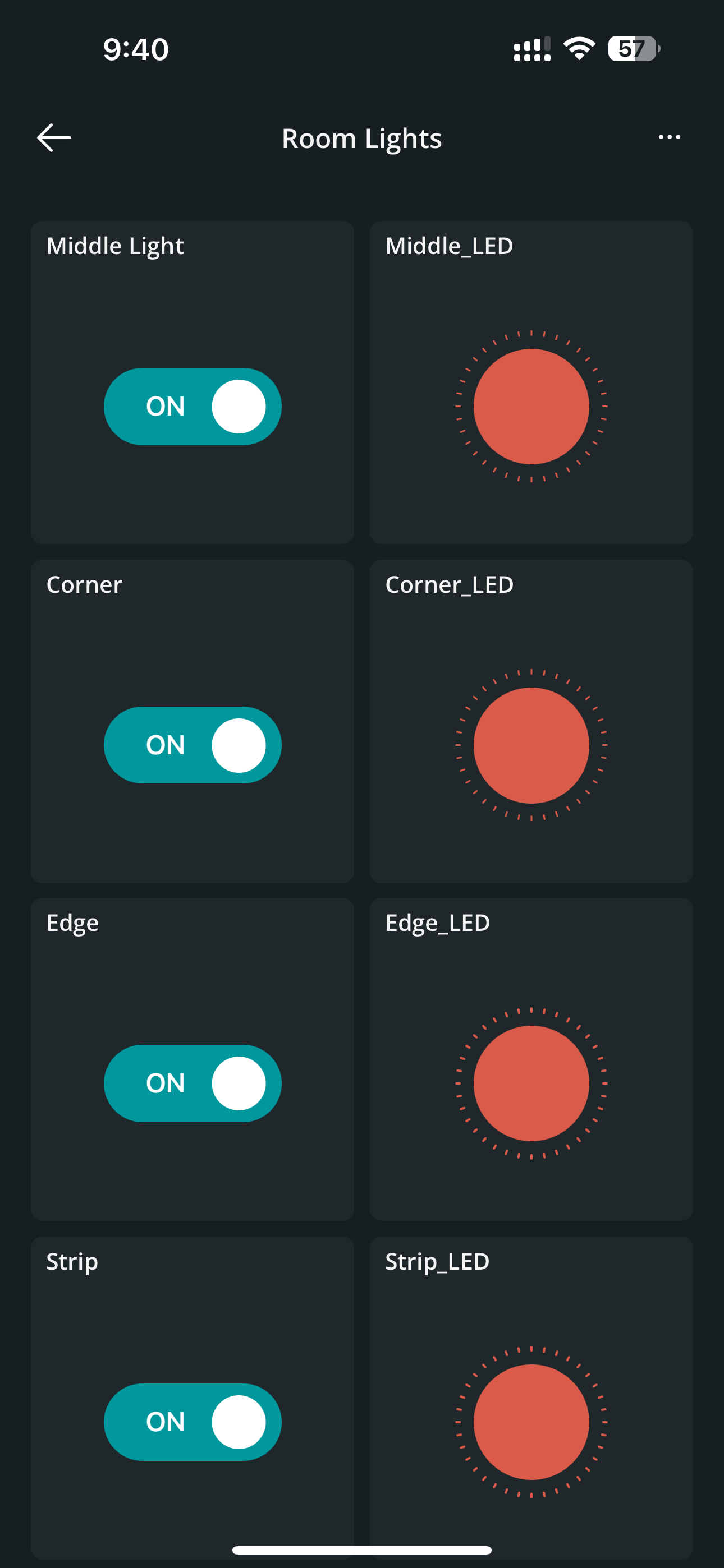

I was making a simple code to turn on and off LED using the IOT cloud. I would send signals from my phone using the iot dashboard and the ESP8266 would receive the signal and send 0 or 1. The signal is being received and the lights turn on, but when i try to turn off the lights, it doesnt work. In the dashboard, i have 4 switches and 4 LED to indicate the on and off of the 4 lights. When i switch it on, it works normally, but if i switch it off, it just turns back on again (in the dashboard). The LEDs on my desk dont turn off at all. I have tried a lot in the settings, nothing works. Cannot figure out the issue.

Use '==' to test for equality, and '=' for assignment.
Turn in the warnings in the IDE preferences, you would have been, um, warned.

i feel so dumb. Thank you so much. This has bugged me for longer than i would like to admit.
You are the very first person to ever make a mistake like that. :wink:
Go now and fix the default settings in the IDE prefs, heed the warnings about this and a small handful of other common things that the compiler might think you did not mean.
