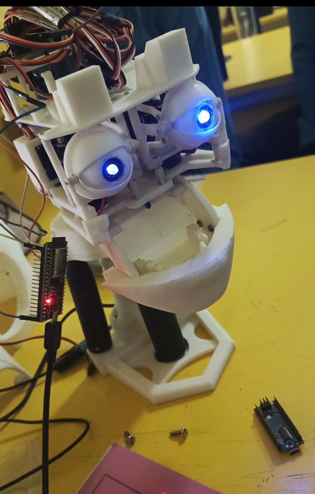

I have a project where I have to use both servos and LEDs, So my question is that can I use both servos and LEDs with PCA9685 at the same time?
I am using mg90s servos and a normal 5mm LEDs lights.

I have problem with my LED setup, I am using two same LEDs but one is less brighter than the other, what can be the issue.
I can't replace them so is there any other solution?
Variants:
  • use different resistors (or an additional resistor on the brighter LED)
  • use PWM pins and drive the LEDs with different PWM
I need the high brightness in led with lower brightness.
Is it possible or I have to low the brightness of brighter LED
either fix the root cause of your installation (there must be a reason why one LED is brighter)
or dimm down the brighter one.
I presume you have each LED on a separate channel on the PCA9685.
Maybe a bad/damaged channel on the 9685? Switch the wires to the LEDS. Does the dim LED change to the other side?
If you want the brightness to be the same and bright, then you need a constant current LED driver. Otherwise you will need to play around with the current limiting resistors for both LEDs until you get them to match and they may not be the brightness you like.
