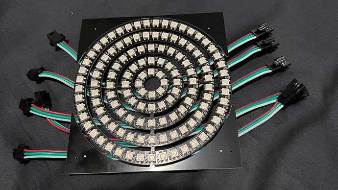

hello all, being an almost total newbie i have some questions. I have recently dragged a leonardo out of storage, its been in a plastic tub for some years. plugged it in and it powered up and ran the blink program. So that part of the equation works at least. I bought 5 led rings of ebay (today), each is a different size and from what i can see they have joiners at each end and plug together.
My intention is to have each ring nestled inside the next biggest size and end up with a round graphical display. I envisage running a countdown sequence around the circle, each time i get to the end of a circle, i move to the next inner ring. This will all be mounted on a perspex board.
The leds are 5V WS2812B 5050 RGB LED Pixel Ring Panel Lights and are Individually Addressable
there's a total of 128 leds. I have a variable power supply 3-12v at 5 amps. I have some concerns that may not be enough. I read somewhere that 5v leds are about 1.5 amps, per 30 leds. So at 90 leds i might be at 4.5 amps which leaves me a bit short, i think.
I think for testing purposes, i can limit my output to less than full brightness or leave out a ring, so that i don't melt anything. I also plan on using the fastled library to run it. That seems like the easiest way to do things. Am i overlooking anything ?
For 128 ws2812 LEDs, the current could be up to 6.5~7.5A. That is with all 128 LEDs at full brightness white. Other colours, patterns and animations will probably use much less.
FastLED has a function which will, if you set it appropriately, automatically reduce the brightness to keep the current under a limit you specify should the patterns/colours displayed need more than that limit.

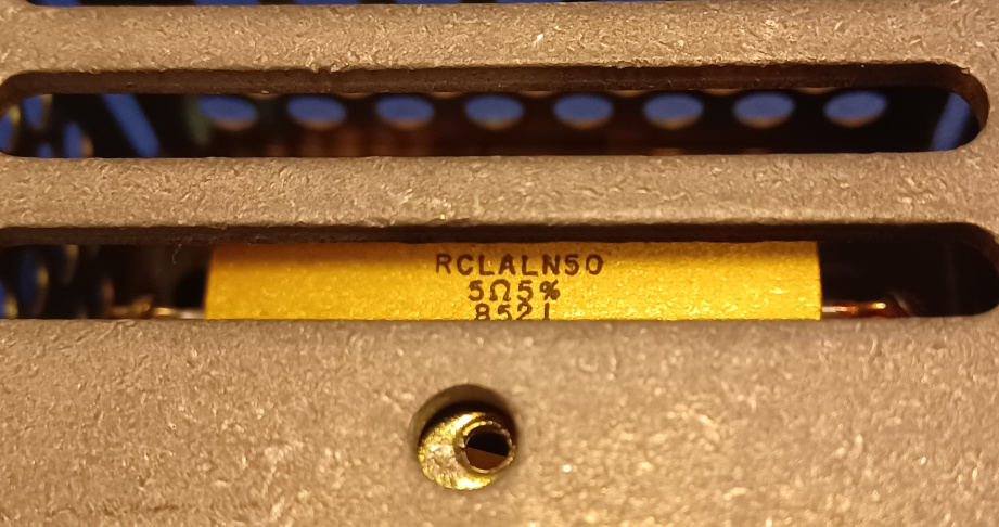

I have a 5ohm power resistor on the 5V line.

some what curious, as to where would i be likely to find a 5 ohm resistor ? which type of equipment is my best bet ?
Its probably just as easy to buy one of ebay however in the interests of learning something, i should probably keep my eyes open.
It is a Dale wire wound 5ohm 5% 50 watt. It was a surplus load resistor for a higher voltage supply, so the 50W is overkill for 5V. It has a protective cage around it - possibly to keep people from touching it.
Thanks for the info. I presume i'm only likely to find something like that in older electronic units. Newer mass produced items arent going to built quite like that i guess. I didn't actually intend it for 5v. i was thinking more along the lines of doing a pc power supply conversion after i finish messing around with leds.

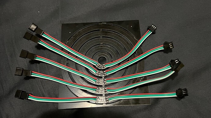

Speaking of leds, my rings arrived today and i'm quite excited. Heres a couple of pics of what im working with.
