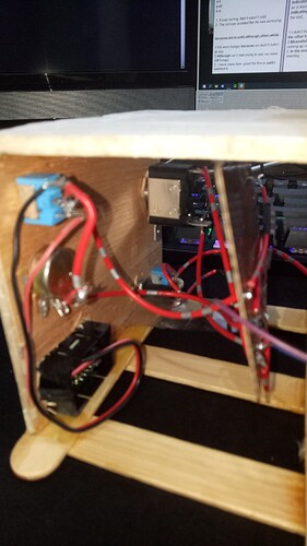

Im using a Arduino Leonardo trying to run 2 servos using a switch, Using pin 9 and 10 as output and using pin 8 and 7 as input and running 2 servos from one 5v output and running the switches to the inputs, and all of the input pins are going low high like crazy!
What can I do to fix the input pins going low high?

For a start, you could investigate how switches are normally wired instead of making it up.
i have used a multimeter to check the way the switch works
A multimeter doesn't see the switches the way a processor does.
https://www.arduino.cc/en/Tutorial/BuiltInExamples/InputPullupSerial
It also likely that you made a wiring error, compared with your diagram, so please post images of your hardware.
oh really? im new to this so.
That's what the example sketches and tutorials are for. People who are new to it.
Also see
https://www.arduino.cc/en/Tutorial/BuiltInExamples/Button
Your switch inputs are floating. From the tutorial:
"If you disconnect the digital I/O pin from everything, the LED may blink erratically. This is because the input is "floating" - that is, it will randomly return either HIGH or LOW. That's why you need a pull-up or pull-down resistor in the circuit".
Green == Common 5v Purple and Blue == Input Pins

It is not fine. 3.3V and 5V logic levels are different. But it is not your only problem.
because im running 2 UN-LOADED servos and I'm too broke to get a 5v supply, wait how much current does a servo use when its unloaded?
so what i learned so far is I need a pull-up resistor and connect it to ground, and use 5 volts for logic I/O input
