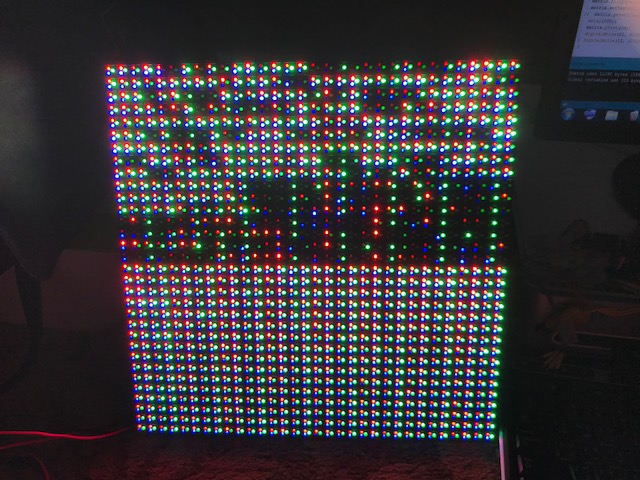

Yes you are it is that PCB on the back of the display, the one that showed four of them on that first link but only one on the corrected link.
Aha, I thought I would need more driver modules.
That one is fixed to the panel from the factory, I'm trying to unscrew and check if possible.
Did you check the English data sheet in reply #16 ?
I think it tells many things but i'm not that good to figure out whats going on wrong with me that not making the library work fine with my panel.
while it's totally okay with all other panels that I tried with.
In attachment there is a wiring diagram I just draw I hope it will help.
Thanks. I would have thought you would have to wire to both sockets on that driver board, try wiring to the other unused socket and see if you can access the other half of the LEDs. At the moment don’t wire to both sockets at once as you can’t common up all the pins.
That was really something I didn't think About.
I connected to the other port and the first thing I noticed, It powered up the Arduino with out being coneected to the USB port. :grin:
then I tried many times to make sure it gives me the same result and I'm not doing something wrong.
2 times all screen is off
2 times shows the same as in attachment.
That really sames to be logical as we need to plug in two power inputs to one panel :wink:
And I need to mention that I used to have 16x32 Hub75 and only one Hub08 LED Controller where I need to make some tricky wiring to convert between them that includes shorting from R1 B1 G1 on the input port to R2 B2 G2 in the output port.
but this might be another story and more complicated and far away from this case.
I strongly feel we need to connect to both ports but how?
I that was a smart thinking of you. :sunglasses:
So to be clear are the LEDs in the part of the display normally out of reach actually changing now? With the parts that changed before not changing?
Nothing but I did some tests using this sheet trying to figure out if it's from the wiring or from the code.
I used this sketch and changing in it gives me different results :

Result in (here) is the result of the inputs in the Excel sheet from one port and in realty is more clear and okay on just on the Exact right side only.
but then I tried to change in the code with the number 128 to make 64 and (127-i) to be (63-i)
with the same inputs and different drawing and it was giving me double picture of the right side but a little bit pulled down like in (Here).
then I used huidu led controller from only one port with the same wiring and it gave me (This).
So what I figured out the wiring is okay and it can be controlled from only on input port.
and we need to know how we can change in code to make it draw properly on both sides.
