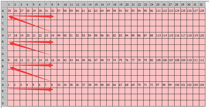

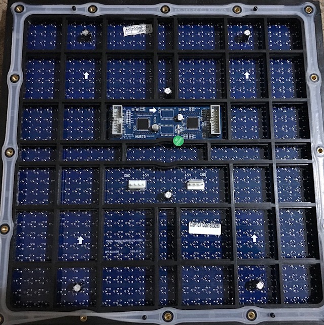

Hello Everyone,
I have asked about my problem many times everywhere and I couldn’t have it solved yet.
For that I decided to make this topic for everyone who wants to share and challenge solving this problem.
If you succeed with whatever please share everyone.
To participate you will only need:
- One Arduino UNO.
- One LED Module or Panel (32x32 - ¼ Scan Rate)- *Dip Type is preferred.
- Download the RGB Matrix Panel library and Adafruit GFX Library then put them in Arduino>libraries folder.
- Replace RGBmatrixPanel.cpp and RGBmatrixPanel.h with RGBmatrixPanel.cpp & RGBmatrixPanel.h.*(Modified files for 1/4 scan rate panels)
- Some Jumper Wires.
Connect as follows:
CLK To 8
LAT To 10
OE To 9
A To A0
B To A1
C To A2 *(I don’t have it on my panel)
D To A3 *(I don’t have it on my panel)
R1 To 2
G1 To 3
B1 To 4
R2 To 5
G2 To 6
B2 To 7
GND To GND
*My Panel Has only A & B Where C & D are grounded and not there.

Because my project is all about getting numbers from Serial Port, for that I’m sending the numbers from the Arduino program directly from: Tools>Serial Monitor
I just write some numbers on the Serial Monitor upper text box and make sure they look good on the display panel.
You can change font size from this line ( 1, 2 or 3 )
matrix.setTextSize(1);
Now let’s see what happened with me:
Typing number 4 one time with font size 1: (If not shown see attachment LED Panel1)
Typing number 4 three times with font size 1: (If not shown see attachment LED Panel2)
Typing number 4 one time with font size 2: (If not shown see attachment LED Panel3)
Have fun trying the code with your panel if it’s ¼ Scan Rate
And I think it will work fine if your panel is 16x32.
Please share your experience and surprise me if it works with your 32x32 Display Panel.
If you have the (32x32 ¼ scan rate Dip Type) one which has A & B pins and no C & D,
You are more than welcome to solve this issue together,
Thank you everyone and I’m waiting for your results.
