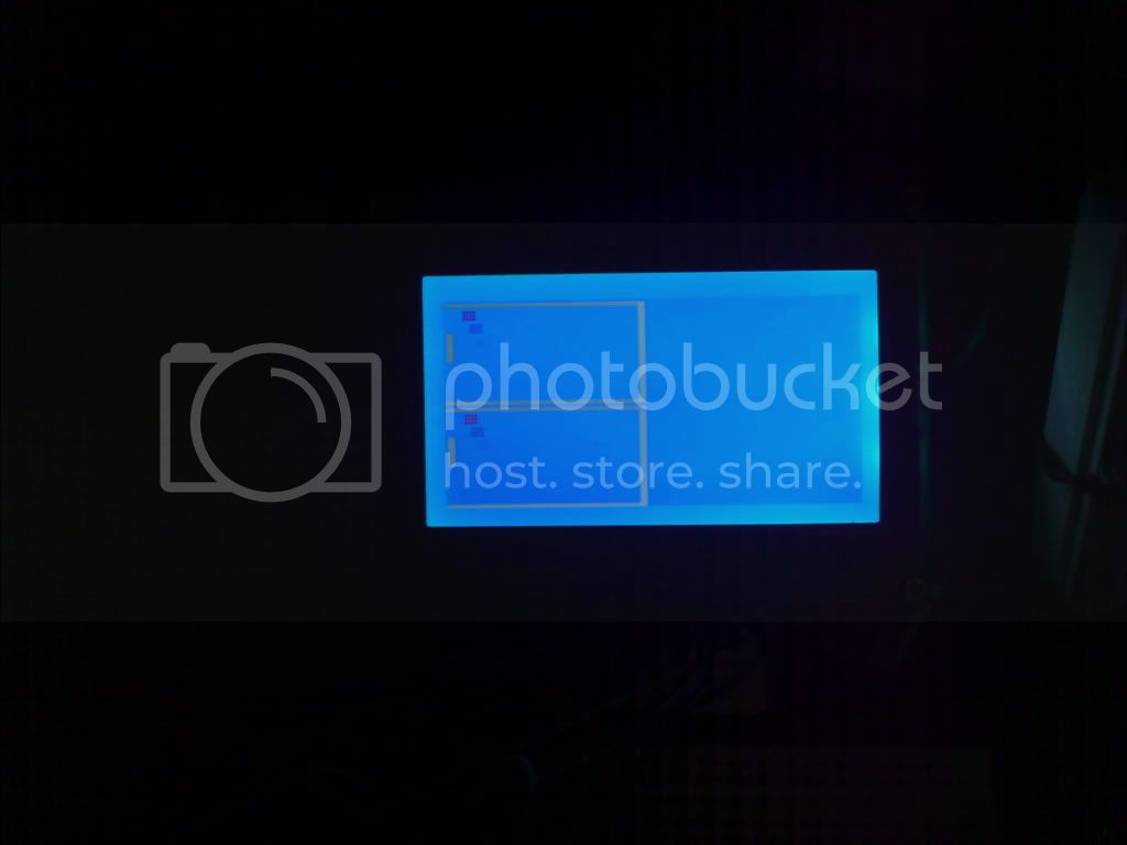

Hi guys, as some of you might know, there is no official library for the 12864 LCD screens If I am not mistaken, they come with an ST7920 chipset, which is cool when you want to display characters since it comes with a very easy interface for adding ASCII, but becomes insanely complicated when adding pixels for the sake of graphical development. Not only must you switch modes (that immediately presents you with a screen of random garbage, which YOU MUST clean up by passing 0x00 to every single pixel through the 8-bit interface), but you also have to deal with a complicated memory allocation system that relies on continous updating of the X and Y coordinates. Anyway, so far I created a library that initialises the screen, and then cleans it accordingly. As a result, direct access is possible. I only started working on this today, so if anyone else wants to get involved, please do! This is the first time I post in the Arduino forums, so i have no idea where to upload the code yet. I value any feedback, and welcome ideas.

Thanks dude. This is what I have implemented so far:
Lines (Breseham)
Circles (Mid - Circle algorithm)
Rectangles
Filled Rectangles
I even made a simple animation of a square bouncing on the sides of the screen (pong style).
Next up is being able to draw bitmaps, and switching from gfx mode to ASCII mode.
I am away from home till Sunday, but I will upload at least the source code and some pictures as soon as I get back. Hopefully more people will get involved with the development of the library.
Thanks for the advice guys =D

OK, I'm ready to post the first version of the library. It comes with an example PONG game.
My only concern is that I have no experience working with wiki pages. Can someone help me create the page on the Arduino playground? Ill start uploading pictures in photobucket.
Thanks =D
I have uploaded the code, and many examples to the Arduino Playground. Thanks for the support guys. Enjoy =D
