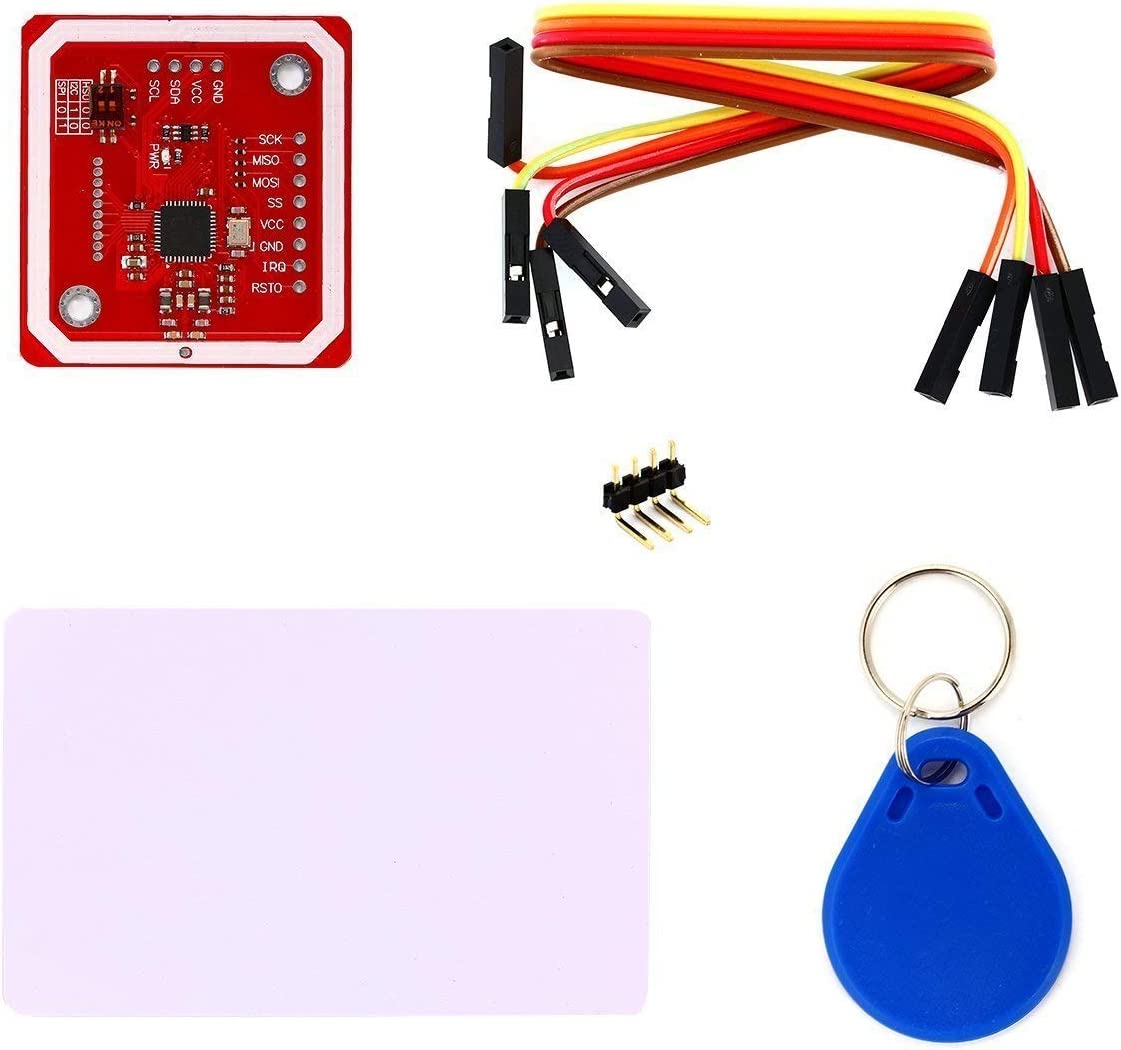

the nfc board is
the nfc board and libraries do not work with Arduino nano 33 ble. I assume because the processor is arm

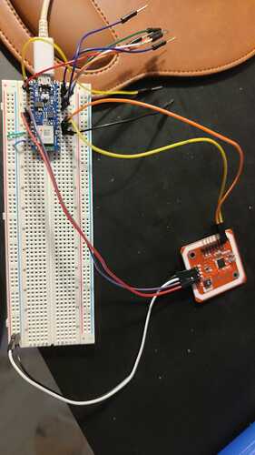

From the photo it looks like you are using I2C?
If so, have you set up the PN532 board correctly - usually there's a switch setting to change - sometimes I2C is not the default setting. Also, if so, are you using the PN532_I2C library.

Just to be sure. Did you test your module with an Arduino Uno and got it working?
yes. the installed libraries are the following

yes i tested the same code on arduino uno and everything works fine. instead on arduino nano 33 ble it crashes here with error Didn't find PN53x board
 nfc.begin();
  uint32_t versiondata = nfc.getFirmwareVersion();
  if (! versiondata) {
    Serial.print("Didn't find PN53x board");
    while (1); // halt
So the function nfc.getFirmwareVersion() failed.
I'm taking a guess here but with NXP I2C there can sometimes be issues with clock stretching on the I2C bus, meaning that some MCU's work while others don't. If you search online you will come across similar problems trying to get esp8266 to work with pn532 via i2c.
Here's a similar clock stretching issue logged on Nordic Semi forum:
Maybe others have a work around.
