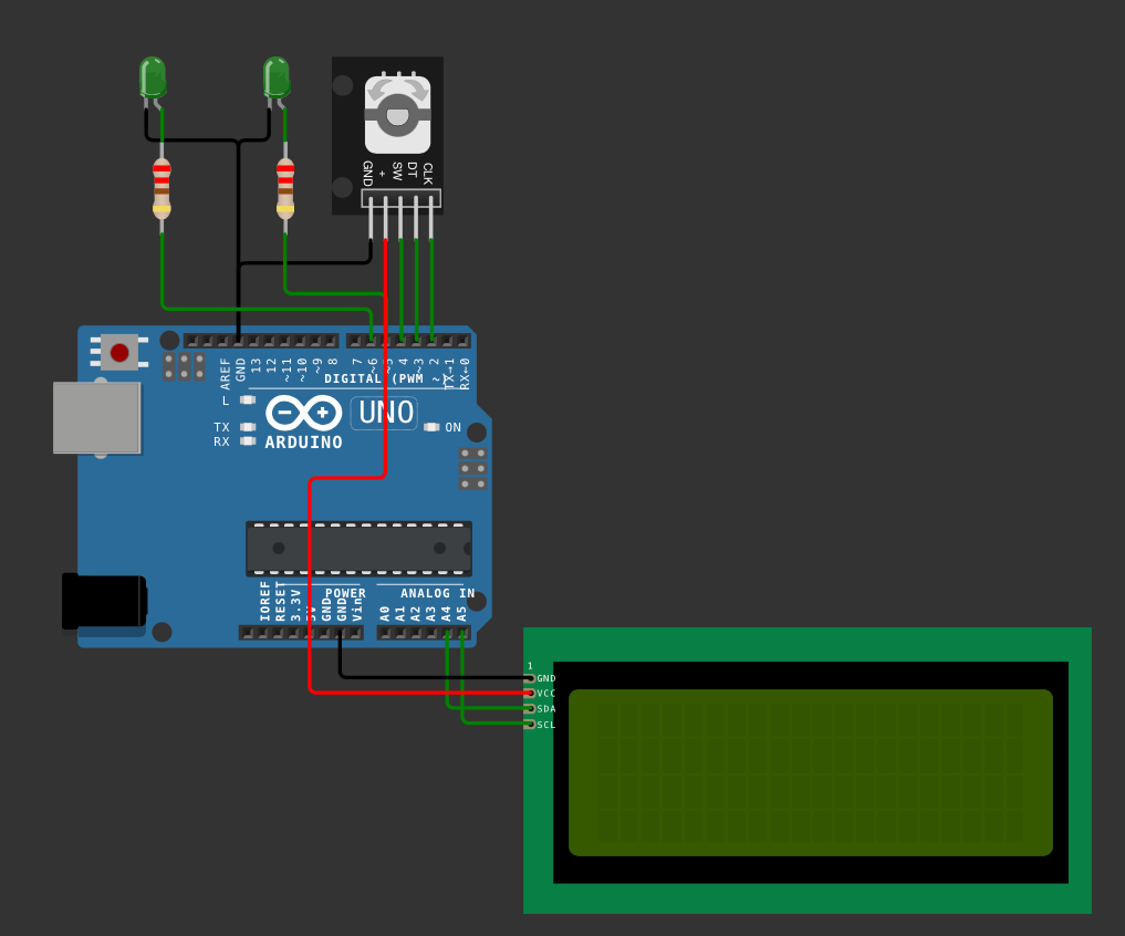

  PIN
   0  NC                        (Rx)
   1  NC                        (Tx)
   2  CLK                       encodeur
   3  DT                        encodeur
   4  SW                        bouton de l'encodeur
   5  200Ω --- Led Anode        Green led on breadboard
   6  200Ω --- Led Anode        Green led on breadboard
   7
   8
   9
  10
  11
  12
  13
  A0
  A1
  A2
  A3
  A4 LCD SDA                commande du LCD
  A5 LCD SCL                commande du LCD

No one get better at playing tennis by playing with beginners.I am learning, yes. I guess that forum is meant to shre for those who want to. Not to compete with who is higher level or not. I am wise enough to navigate trough all your generous shares and do my home work on my side.
I will try to be more precise in my demands instead of posting full codes. Good Idea. Thanks for the hints.
I already did the set up of the encoder with to leds to really know what kind of pluses/detents I got. That said. The knoledge you share will be helpful. Thanks for that!
Okay I will do this in c programming language book. I got to remember the functionning of arrays now. I am watching var per var in the code you sent me and I mannage to figure out each part by changing var names to make it mine Now I will check the beta and gamma stuff... Will get trough it. Thanks for your shares.
Because thoso I understood I put them commented out. The one I kept alive is the one I did not understand. ( *lbl ) that was just for the question post

I slightly changed this code from J-M-L jackson to force the values going back to MinValue when I hit the MaxValue by turning the rotary CW; it works.
but vice versa...
I want the same to happen when I hit the minValue turning the rotary CCW i.e. go to maxValue.
It does not work so I had to set it as it just stops to minValue instead of going to Maxvalue when turning CCW.
What is my mistake?
bool menuChanged(){ //issu de encoderChanged
  long newPosition = encoder.read() >> 1;  //ajustement type encoder
  if (newPosition < encoderMinValue) {
    newPosition = (encoderValue );  //encoderValue au lieu de encoderMinValue ou encoderMaxValue
    encoderSetValue(encoderMinValue);
  } else if (newPosition > encoderMaxValue) {
    newPosition = encoderMinValue;
  if (newPosition != encoderValue) {
    encoderValue = newPosition;
    return true;
  return false;

I didalready, but it printed on serial monitor when I hit lower than 0 turning CCW:
0
20
0
20
0
20
What does your encoderSetValue() function look like?
As you can see from this question. It is better to always post your most actual and complete sketch.
void encoderSetValue(long newValue) {
  // as encoders can have multiple ticks, we need to take into account possibles ticks that have been engaged
  long ticks = encoder.read() & 0b11;
  encoder.write(newValue << 2 + ticks); // Propably here the trick for Min to Max when CCW
