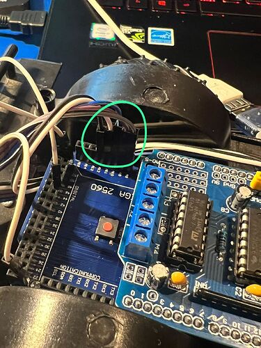

Hi! I recently bought a line following module like this one https://microohm-eg.com/product/5-channel-line-follower-tracking-sensor-module-bfd-1000/ .
I don't know why it is not working. Every time it is showing 2500 in the console, and if i move it far away from the floor (50cm) it shows 8.
Also, the leds on the board are showing the same results.

How is the module connected to the Arduino ? A schematic would help
Please post teh sketch that you are running, using code tags (the </> icon) when you post it

I connected the pins as follow:
IF you actually want to receive help, you need to tell us what the pins are connected to and what the device is supposed to be sending. Right now you are the only one with documentation and we can't see it very well.
I didn't find any documentation, but the pins are connected as the diagram shows above. From what I found on internet, you get a binary value (1 - line , 0 - not line) on each sensor pin.
The tests I did above shows that the value is constant 1 logic. It changes just if I move the sensor further away (50cm).
Do you mean the picture? Totally useless. Make a pencil drawing.

Here it is.. the 2nd diagram.
I need to mention that I tested the sensor in every way I could. Even with a line on the floor, at different distances (0 to 4 cm) and with different colors (bg black - line white, bg white - line black, etc.).
Then what is the problem you are trying to solve?
As I shown in the output above, the sensor is giving 1 logic every time, even if the line is under it. Maybe you know what causes this problem.
