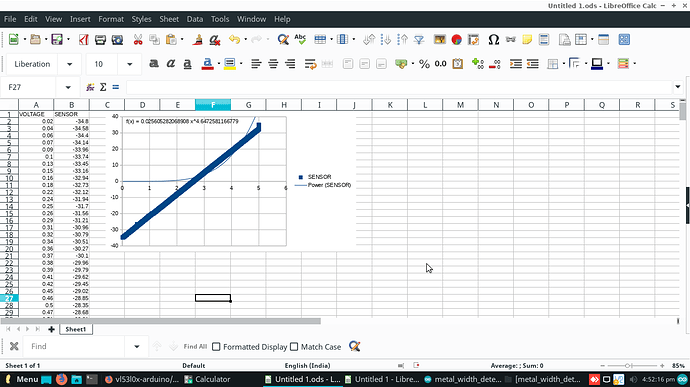

Hello guys,
I have used the map function in the arduino code. ```
float val = (float)(map(samplse,0,1023,-3500,3500)/100.0);
`0	 -35
2.61 0
5	35
 Here I have taken calibration values from the sensor and plotted a graph. First when I use the power graph, I got **NAN x^NAN**. But when I use the calibration values with linear graph, I got **13.9909711599448x - 35.4904301757266**.
My question is why in power graph, I am getting NAN. Then If I want to add the calibration values of linear graph in the arduino, how will I implement?

NaN, Not a Number. Using a Uno/Mega? Most likely the NaN is being caused by a overflow.
You may, also want to normalize your data.
I used a 32 bit Linear Regression formula that was prone to overflows and gave NaN's. I switched to a 64 bit LR.

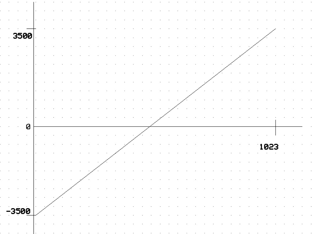

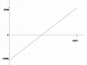

Your equation from the map parameters transforms to this graph.
y = mx +c
m = gradient
c = y value when x = 0
m = rise /run = (3500 - -3500)/ 1023 = 7000 /1023 = 6.842
c = -3500
y = (6.842 * x) - 3500
Which is the resultant equation used in the map function.
you divide b y 100 so
y = (( 6.842 * x ) - 3500)/100

I am telling the calibration means taking the samples of voltage and the sensor readings and use excel for getting the equation,
Is my calibration correct or what can i do?
you need to explain what you mean by no accuracy?
can you provide the raw data, in text not an image?
Accuracy in sensor when I use this map function float val = (float)(map(samplse,0,1023,-35000,35000)/1000.0); Serial.println(val); , I am getting the the value for example 31.56 in the sensor but in the serial monitor I am getting as 33.90. There is a lot more difference in the values. What can I do to get the accurate sensor values in the serial monitor?
How will I calibrate?
