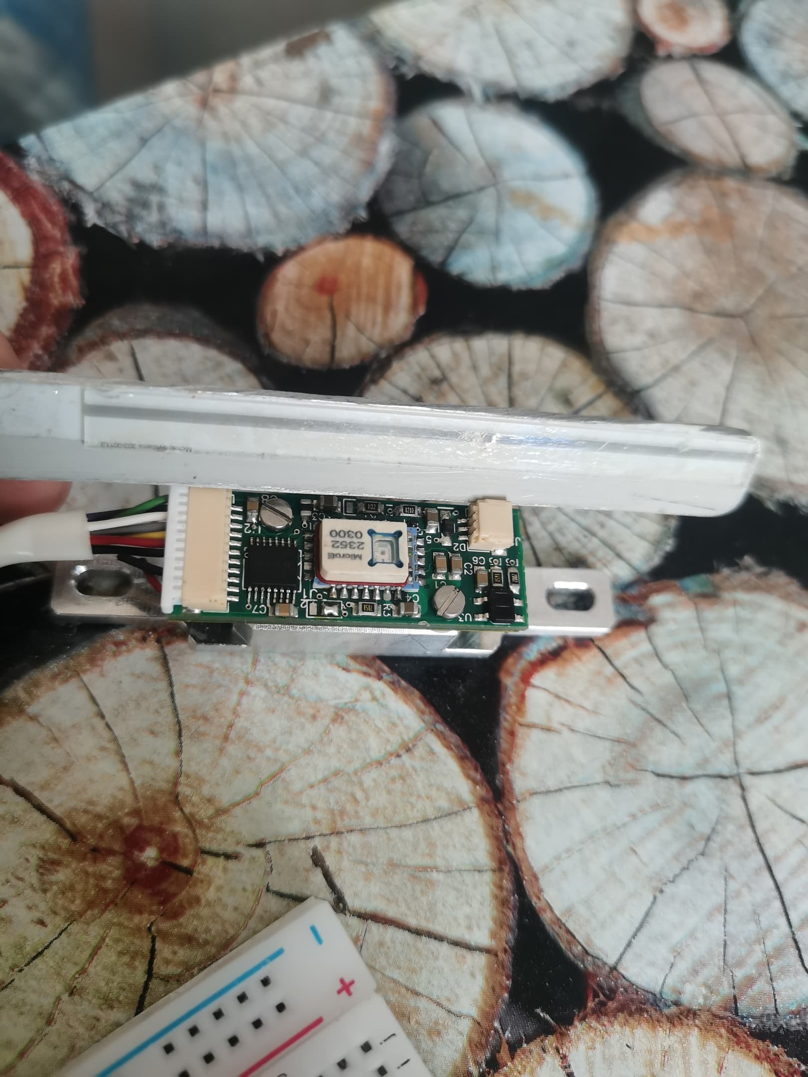

Good day. I purchased a linear encoder.
Trying to test it, I assembled the following circuit.
I wrote the following code
int PinA = 12;
int PinB = 2;
int val = 0;
int val2 = 0;
void setup(void) {
 pinMode(PinA, INPUT_PULLUP);
 pinMode(PinB, INPUT_PULLUP);
void loop(void) {
 val = digitalRead(PinA);
 val2 = digitalRead(PinB);
 Serial.print("A value: ");
 Serial.print(val);
Serial.print("\tB value: ");
 Serial.println(val2);
I get the following result
Channel B reacts to changes and changes 1 to 0 when touched by the laser. Channel A does not react to anything, it constantly hangs at 0. I think maybe I screwed up somewhere in the connection diagram. Does anyone have an idea why channel A does not work? And what is this 5 channel that says that it is a reference channel, no matter how I connect it to + and -, it does not affect anything.

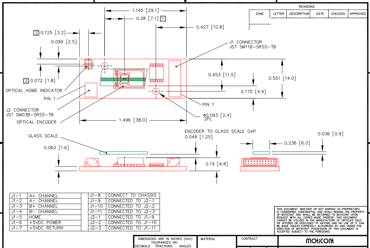

The web page you linked to says that the outputs are TTL Differential Quadrature Outputs. You might want to explore this.
I'm not sure whether you should be grounding the A- and B- outputs, they look like they are complementary to the A+ and B+ outputs, for connecting to RS485 - TTL converters.
The documentation provide by the seller is poor.
Connected A- (А2) and B- (Π’2) to the input.

B1 (B+) and B2 (B-) change their value when touched by a laser. But A1(A+) and A2(A-) are const = 0;

Can you please post some images of your project with the linear scale fitted?
Yes, A- and B- are just inverted signals A+ and B+. Most likely, when connecting them to ground, I burned channel A. That's why it refuses to work.
Most possibly not, as when the output BJTs would be turned ON, they would short the relevant output to gnd anyway, otherwise the equivalent of open circuit.
I just move the ruler back and forth
Is that linear scale still in its plastic bag?
Have you moved the laser head along the grey bars on the slider?
The magnetic ruler is glued to a wooden board. Yes, the sensor moved along the gray strip.
It was definitely a mistake to connect the A-, B- differential signals to ground, but whether that damaged the outputs depends on their internal structure.
For example, if the outputs are open collector/drain and are intended to be used with external pullup resistors, then no problem. If the outputs are totem pole, then they could well be damaged.
The documentation is nearly hopeless, which I do not expect for such an expensive item, so your best option is to test the encoder on the bench, using an oscilloscope and other test equipment to examine the output signals.
