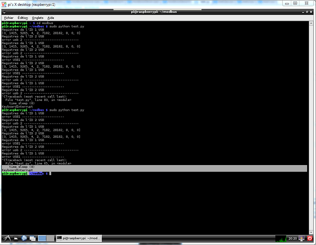

I tryed now with arduino library Modbus-Master-Slave-for-Arduino. and with this i can retrive respnse but i haveit only sometimes. see the attachement 1.

and this is my python code on RPi for test:

tankyou another time to help me and sorry for my english i’m french boy
