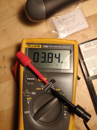

Is there a meter test I can perform across the pins ?
If you use a multimeter in Ohm, there should be no shorts between two pins, in both directions..

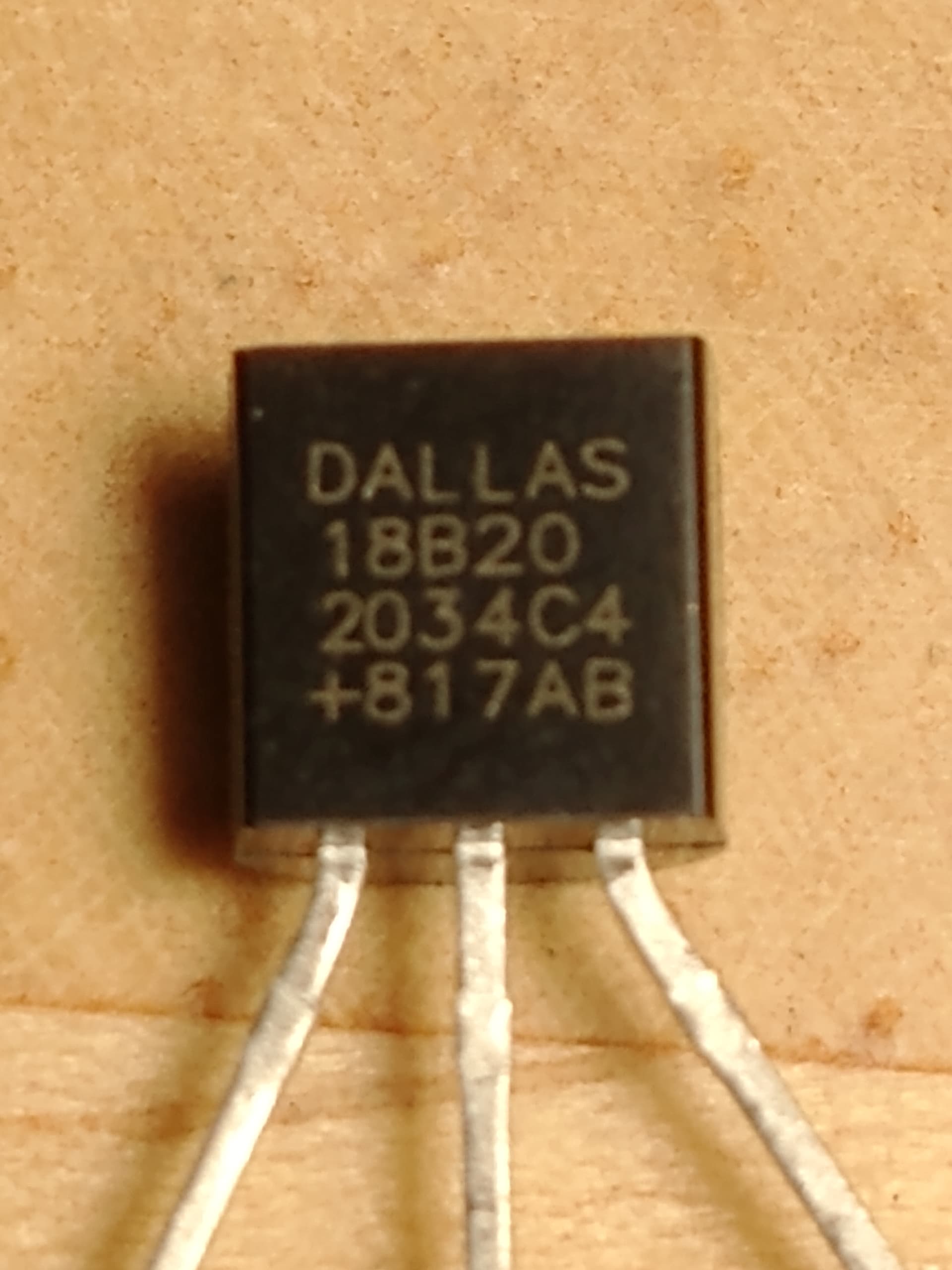

Here are some pics. Should I be reading a resistance across the sensor. some are 10M ohms
That is not a LM35.
It is a Dallas 18B20.
It requires a different program to a LM35.

https://datasheets.maximintegrated.com/en/ds/DS18B20.pdf
You have it wired wrong!!!

Ok it is working properly now.
Not sure why I thought the LM35 and the Dallas were the same sensors. My Bad
