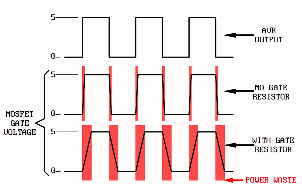

Good circuit, but I would do away with the 470 ohm gate resistor. All that will do is, due to the mosfet's gate capacitance (made worse by the Miller effect), is slow down the switching time and cause the fet to stay longer in the "power wasting, heat producing" linear region. No need for it, and since the AVR output are also mosfets, their inherent on resistance (between drain and source) will easily absorb the "few microseconds at most" overcurrent spike caused by the AVR output forcible charging (or discharging) the gate. Remember, a mosfet conducting is equivalent to a resistor, and that resistor will not overheat in such a short time.
This sketch explains it. Of course, the waveforms depicted are linear when in fact they should be typical R/C charge/discharge curves, but the idea is not lost without the proper curve shape (and it would have been a pain to draw it).
(click image for full size)
You can also see that since the power wasted area remains constant, the total waste is proportional to thr PWM frequency. If the frequency were high enough, the power wasted areas would touch (or even OVERLAP!). Not a good way to use a mosfet.
Do so if you wish, but this is bad advice.
The gate capacitance acts as a temporary short circuit, and the drive current will exceed the output pin specification, damaging the Arduino. Always use a series resistor in such an application, 130 Ohms minimum for a 5V circuit.
If you believe that, then you must not know how mosfets work.
I repeat: please don't give such bad advice on the forum.
krupski:
We don't believe it, we calculate it, driving a large capacitive load without a series resistor definitely
exceeds the absolute maximum rating of 40mA for an output pin. However there is no more
detailed information in the datasheet - is that a peak rating or a continuous rating? In the absence
of specific information you just assume its a never-exceed value, and adding a 150 ohm resistor
is the safe thing to do.
It may be the case that the pin short-duration peak current absolute max rating is higher than 40mA, but
we don't have any data.
And we know how MOSFETs work very well.
I wonder why are you so afraid of discrete MOSFETs. You say
MarkT:
driving a large capacitive load without a series resistor definitely exceeds the absolute maximum rating of 40mA
In fact driving ANY capacitive load means lot of current if you ignore parasitic resitance and inductance of wires and the chip itself. So even driving pin connected to nothing is "dangerous". What is worse inputs of other chips are usually MOSFET gates and when you for example connect lot of clock lines of SPI together the capacitive load may be quite large. Yet noone advices to add resistor to SPI lines. And the SPI is switching with much higher frequemcy than a MOSFET!
As krupski explained adding resistor damages the MOSFET if it is switching lot of power. Not using resistor damages Arduino if MOSFET has too large gate capacitance. I think it is clear it is safe to switch small signal MOSFETs without the resistor. If you are switching lot of power and so use bulky MOSFET with large gate capacitance you must use driving circuit or you will burn either MOSFET or Arduino (more likely both). If there is reasonable combination of load/MOSFET that will damage Arduino without resistor but work reliably with resistor is dubious. (You may use MOSFET rated for 100A to switch 10mA but it is "cheating".)
If you are switching lots of power / high voltages you need a MOSFET driver chip anyway...
The kick-back from the gate-drain capacitance can easily take out the protection diodes
in the arduino pin for high power/voltage applications, adding 150 ohms really helps
protect against that failure mode too.
