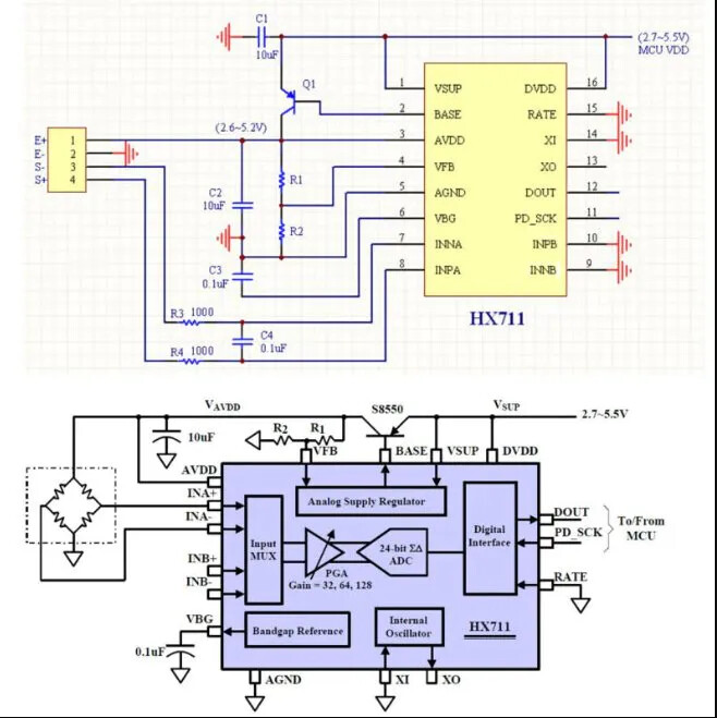

I find this image of a circuit here
here in this website

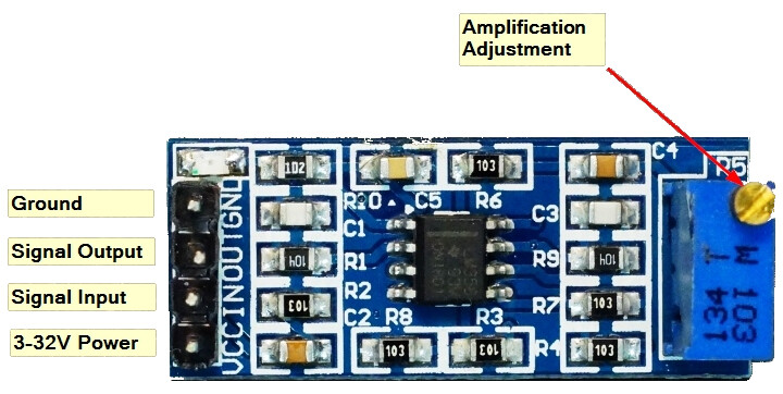

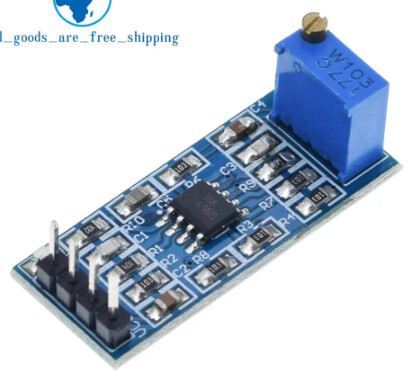

but i have no idea of how to mount this circuit, because my module had only th names VCC, IN, OUT, GND

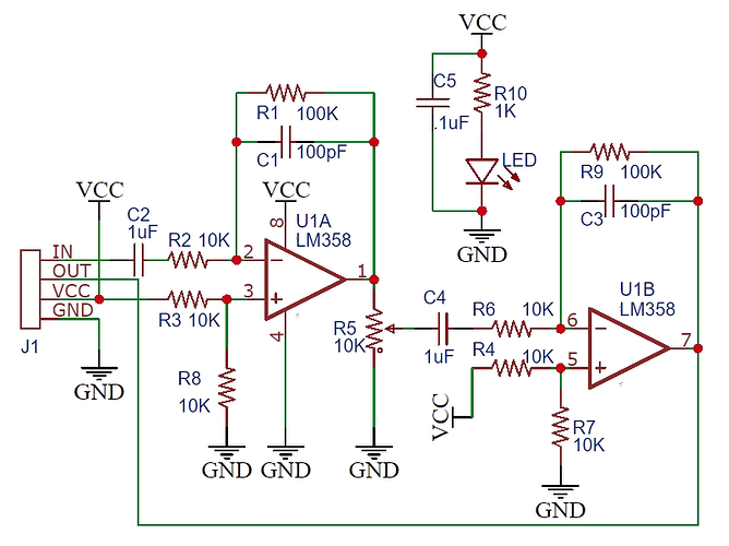

This is your module schematic.
That module is AC only. Unsuitable for a load cell.

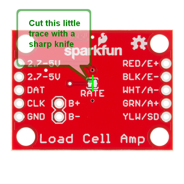

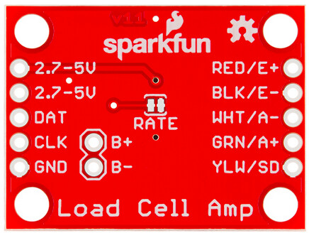

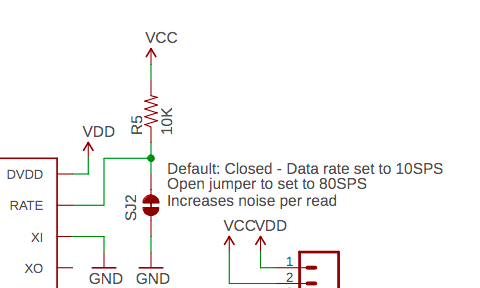

If you have the HX711 module, in the back there is a solder bridge RATE (as Wawa mention) to change the rate from 10 SPS to 80 SPS:
And in the schematic of the module (https://cdn.sparkfun.com/assets/f/5/5/b/c/SparkFun_HX711_Load_Cell.pdf):
Have you tried that?

Noooooo, oh my God, mabe I can try it. Culd you talk more about it, I only neet to weld this gate and HX711 just change to 80hz? Or I need to do something more?

Post#2, diagram#1.
C2 (left, behind IN) blocks DC.
That, and the large offset and drift of an LM258.
You only need a soldering iron, which is a basic tool in this hobby.
Lift pin15 of the chip off the board with a toothpick after melting the solder. Then connect the pin with a short piece of wire to VCC. Google (images) can also show you how.
A Sparkfun HX711 board is of course an easier solution. Just cut the tiny trace between the rate fields with a scalpel.
Leo..
I know, but I moved from my city to star a job as an intern, and I broght a soldier iron with me, but in my city the energy is 127V AC and here in this city the energy is 220V AC. So I cant use any tool tha isn't bivolt. But my boad is a copy of sparkfun board, so I think it will be easy just cut something, I will try it.

The LM358 is a single supply operational amplifier. It runs from a DC power supply and can work with both AC and DC signals, it is not partial.
Cut this trace and it will give you 80 samples/second
