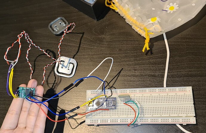

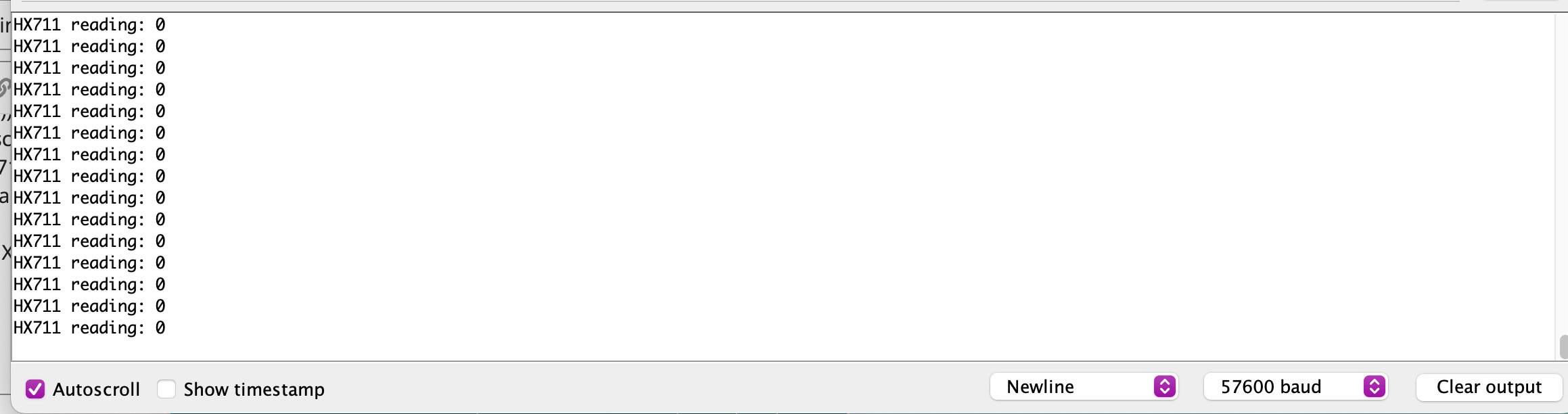

Hi, my load cell is not reading any values. It is giving me '0'. I am using Arduino NANO, HX711 and 2 50kg Square Load cells.
"#include "HX711.h"
// HX711 circuit wiring
const int LOADCELL_DOUT_PIN = 2;
const int LOADCELL_SCK_PIN = 3;
HX711 scale;
Serial.begin(57600);
scale.begin(LOADCELL_DOUT_PIN, LOADCELL_SCK_PIN);
if (scale.is_ready()) {
long reading = scale.read();
Serial.print("HX711 reading: ");
Serial.println(reading);
Serial.println("HX711 not found.");
delay(1000);"
(note that i changed the pins to DOUT = 2 , SLK = 3)
i have checked the connectivity between dout,slk,vcc and gnd to the arduino board.
i have also checked the resistance between A- & A+ (around 990ohms) and E- & E+ (around 900ohms)

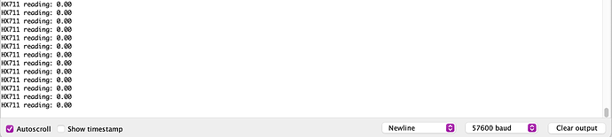

What happens if you change the "long" into "float"?
it changes from 0 to 0.00

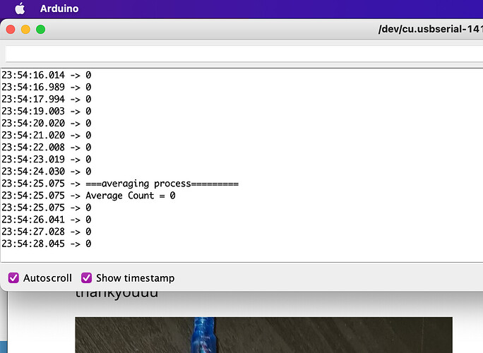

4. Open SM at Bd = 9600.
5. Check that SM shows some counts.
6. Put some weight on the Load Cells; check the count on SM changes.
E+ is 4.22V, E- is 0.015, A+ is 2.10, A- is 2.15
differential voltage about 1.3mv
its still giving me 0 value.

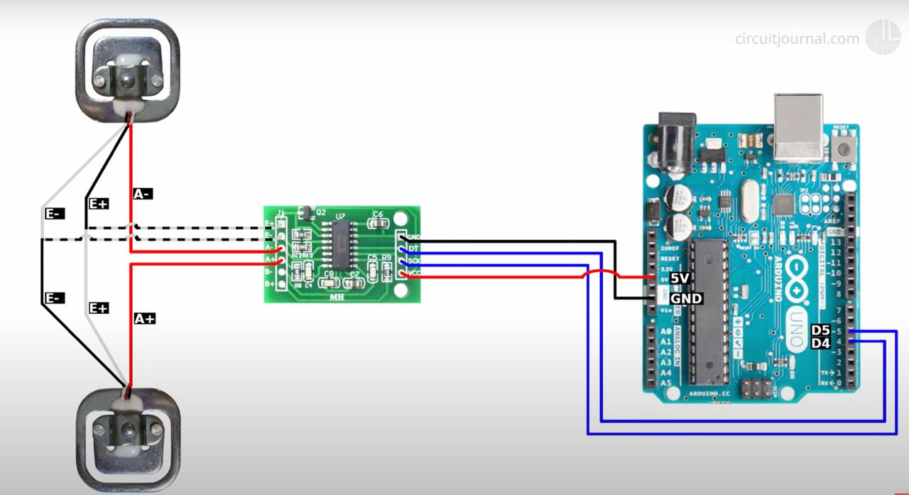

Can we please have a circuit diagram of your project?
An image of a hand drawn schematic will be fine, include ALL power supplies, component names and pin labels.
Hi Tom, sorry for the poorly drawn schematic
(pls ignore the bluetooth module on the right side)
Thankss
Now, you have to follow these trouble shooting steps:
1. Connect resistor network with HX711 Module and then connect the module with UNO/NANO as per Fig-1 using short jumpers. Do not connect the LCD.

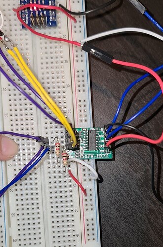

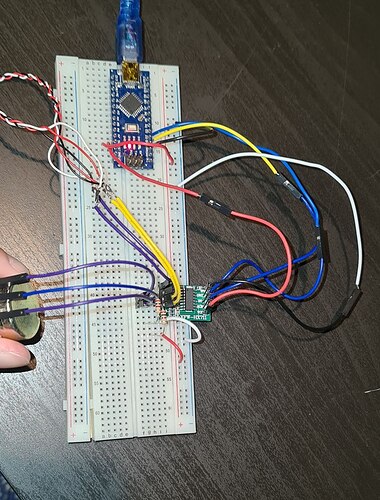

Hi, I'm using the potentiometer to adjust the resistance but the values are still zero. could it be because of a faulty HX711 amplifier?
also, are my connections correct? I'm quite new to this.
thankyouuu
Here's the serial monitor value
hmmmm, they're all giving me 0.00ohms
sometimes it will go up to 0.01 - 0.05ohm
Your jumpers are still too... long. Use single jumper for each connection. Remove the load cell connections completely. You cannot trust the bread board. Some of them are very bad. If have soldering iron, then solder edge connector on the HX711 Module and then use jumpers after continuity check.
Try one more time and then change the HX711 Module if you have a redundant one.
And when you go back to your load cells, put some heat shrink tubes or electrical tape around the connections so the live parts can't touch each other.
:confused:
thanks for the help guys !! figured it out. it was faulty hx711 T.T
