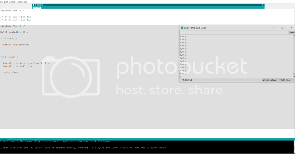

I think I have it all wired correctly and it is brand new... My only question is how do I know if the actual amplifier is shot? All it will ever read is "0g" and I've tried multiple codes.... I soldered the pins in the board and I'm a newbie to soldering so I was wondering if maybe I did too much and messed the board up.
ordered this from Sainsmart.... any help is greatly appreciated!
sorry... thought i was copying and pasting different pictures instead of the same one over and over. :o
I'm pretty sure your soldering is the problem. Those big balls of solder are connecting things that shouldn't be connected.
i cut away some of the bad soldering and that seemed to fix it.... now i'm trying to calibrate it and I'm getting some crazy #s. I've watched youtube videos and my serial monitor doesn't look like theirs. Not sure what to even put in the "analog readout" section since the #s are so crazy..

I will... I just thought this would show the serial monitor as well as the code.
