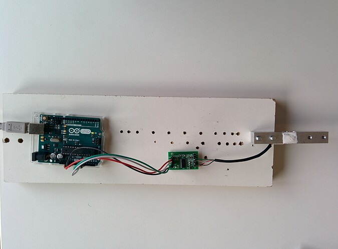

I'm trying to use a load cell to read the aerodynamic forces in a wind tunnel I previously built, but for some reason I'm not able to do so. I followed step by step the guide in this link (I'm using the same library and example code, the only thing I changed are the analog pins, but I already tried with the default ones):
but when I load the program, on the serial monitor I get only zeros or random numbers. At first, changing the value of SetScale in the library, I got some consistent results, although with significant oscillations, but now it simply doesn't work. I tried using 2 different Arduino Uno boards, 2 USB cables, 2 Hx711 amplifiers and 3 libraries, also modifying them myself. I checked the connections with a tester and they appear to be working, so I really don't know what it could be the problem.
I attach 1 picture of the setup I'm using to test the components.
Thanks in advance to anyone who will reply.

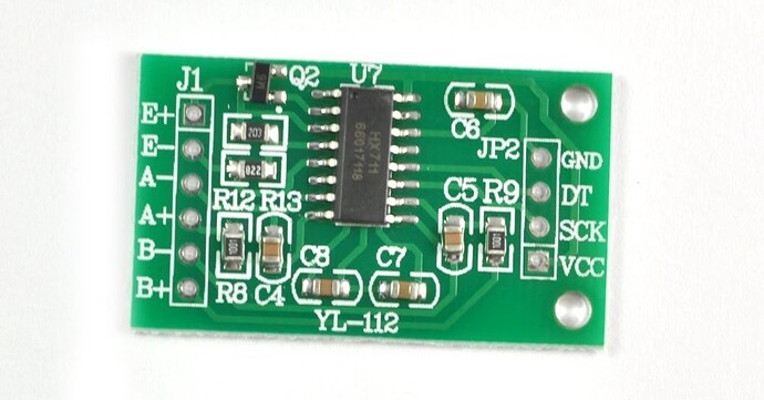

Wiring diagram and code please, datasheets for the sensor and details of the HX711 breakout would be
good too. What gain is the HX711 set to? Is the sensor a full bridge? Have you measured its output
with a multimeter at all?

The sensor should be a full bridge (it's a bar load cell with 4 cables), and the amplifier's gain is set to 128, if I'm not mistaken.
I used a multimeter to test the jumper cables and they appear to work, same for the amplifier. However, when I tested the load cell's alimentation cables (red and black) I got a positive value, but then it dropped to 0 mV.
Now I'm waiting for a new load cell (yesterday I ripped off some connections of the one I was using), maybe the problem was the sensor all along.
UPDATE 3:
today I received the new load cell I bought last week, and it seems to be working better than the other one. Unfortunately, I'm reading some significant fluctuations i.e., without anything on the sensor, the serial monitor prints values between -0.1 g and -20.9 g.
I used a multimeter to check the connections, but everything seems to be working just fine, the tension values measured on the Hx711 pins are the following.
E+ - E-: ~3.8 V
E+ - A-: ~2 V
E+ - A+: ~2 V
A+ - E-: ~1.7 V
A- - E-: ~1.7 V
A+ - A-: ~0.5 mV (is this value correct or should it be higher?)
B3D3:
E+ - E-: ~3.8 V
E+ is the output of a regulated supply, and should be exactly 4.3volt.
If not, then there is something wrong with the 5volt supply or the load cells or wiring or your DMM.
Leo..
Thanks for the input, maybe I soldered poorly the load cell to the amplifier, I'll try making some better connections.
