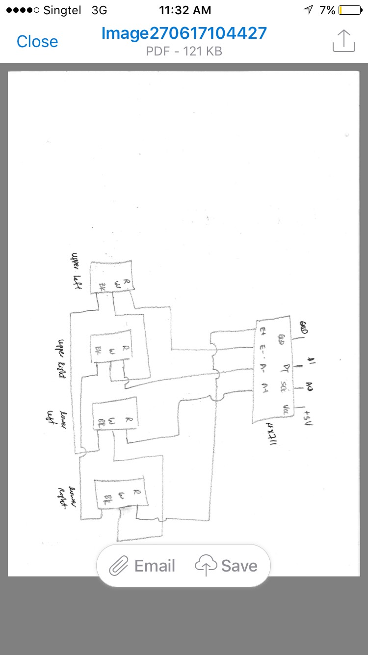

My name is James. I recently bought 4 Load sensor 50kg (3 wires), a Hx711 amplifier (green) and a bluno nano microcontroller. I saw some load cell hook up diagrams and tested it out but I can't seem to get the readings from the serial monitor. Please advice as I really need this to work for my final year project.
Post a schematic of your wiring. Post your code. Describe what the code does, and how that differs from what you want it to do. That is the mimnimum that we need to be able to give intelligent assistance.

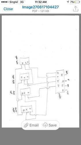

I have attached a circuit diagram.

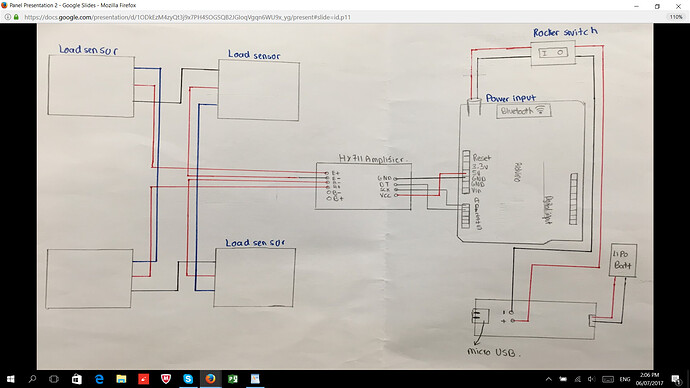

I really need help for my project on Load Sensor. I bought 4 Load sensors 50kg - Sen - 10245 and connected it this way shown below.
I bought 4 sensors, 1 hx711 amplifier and one bluno nano (micro controller).
When tested with supporting at the sides and pressing the middle using fingers, the readings fluctuates.
Please advice me as this is a major project I've taken up on and i require it to work.

Thanks for the schematic.
Try google connecting 4 3-wire load cell arduino
One of the results gives your circuit and another wiring arrangement.
and
it refers to
http://www.scottcutler.net/catpoop/catpoop.html
that uses a HX711.
OPs schematic.
Now we need you to post your code.
