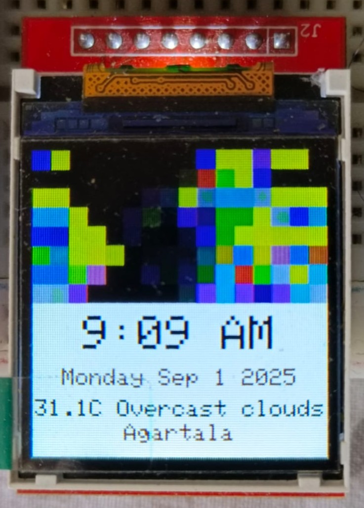

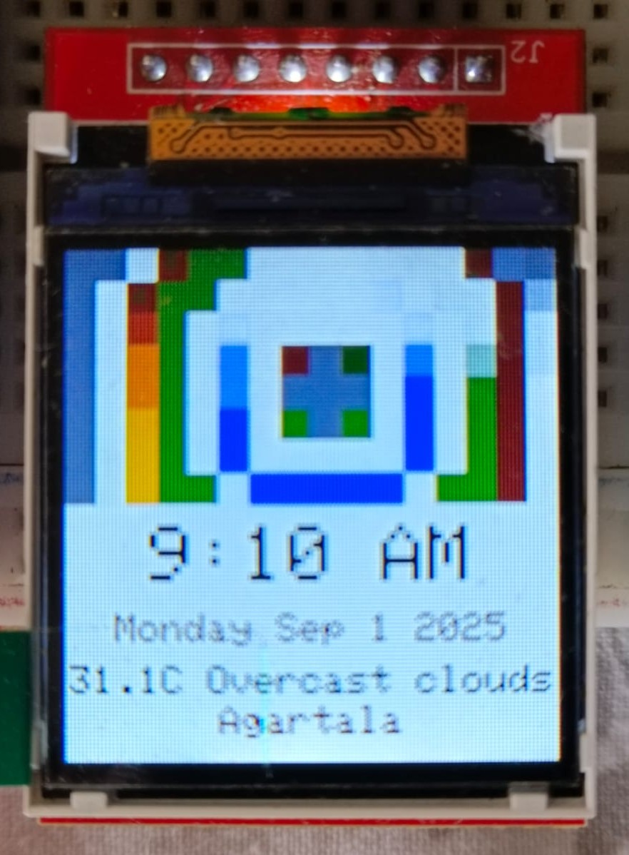

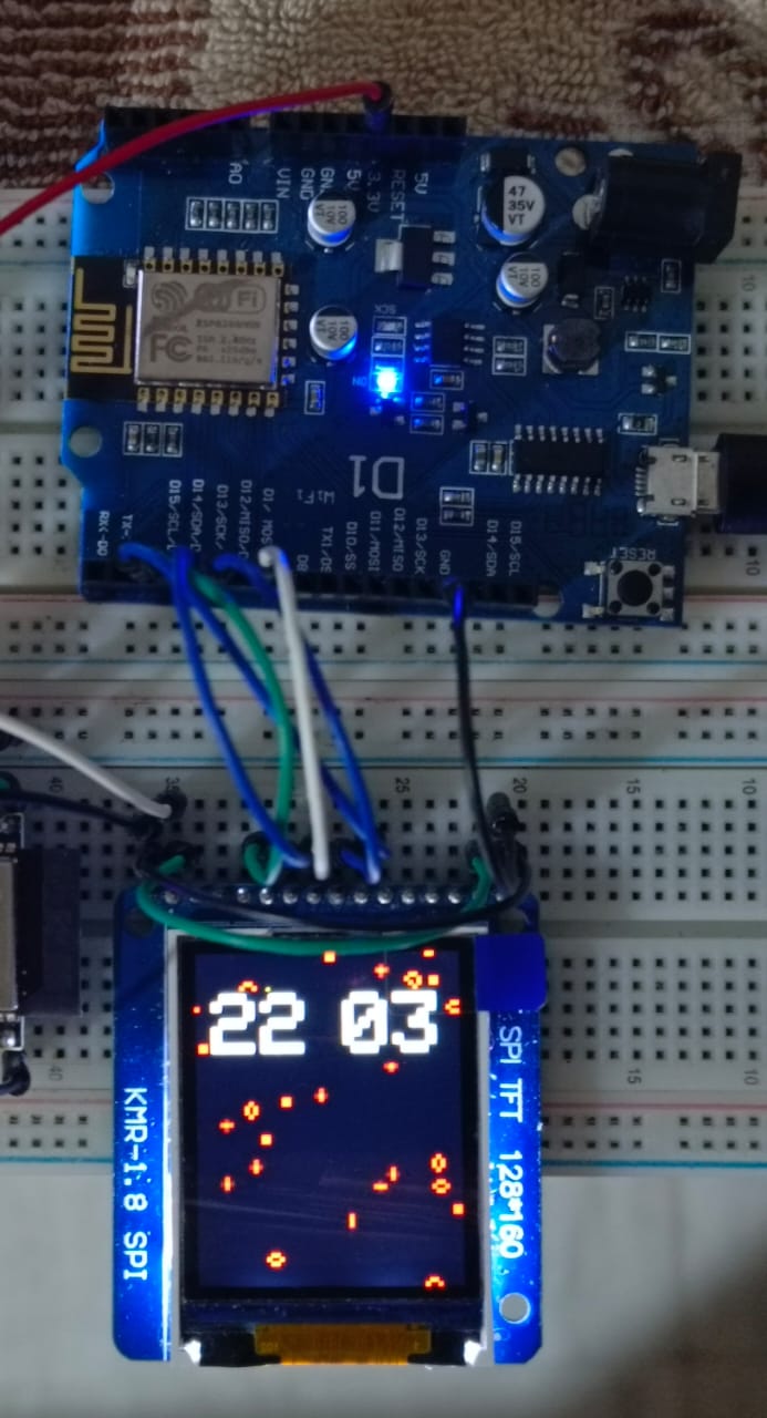

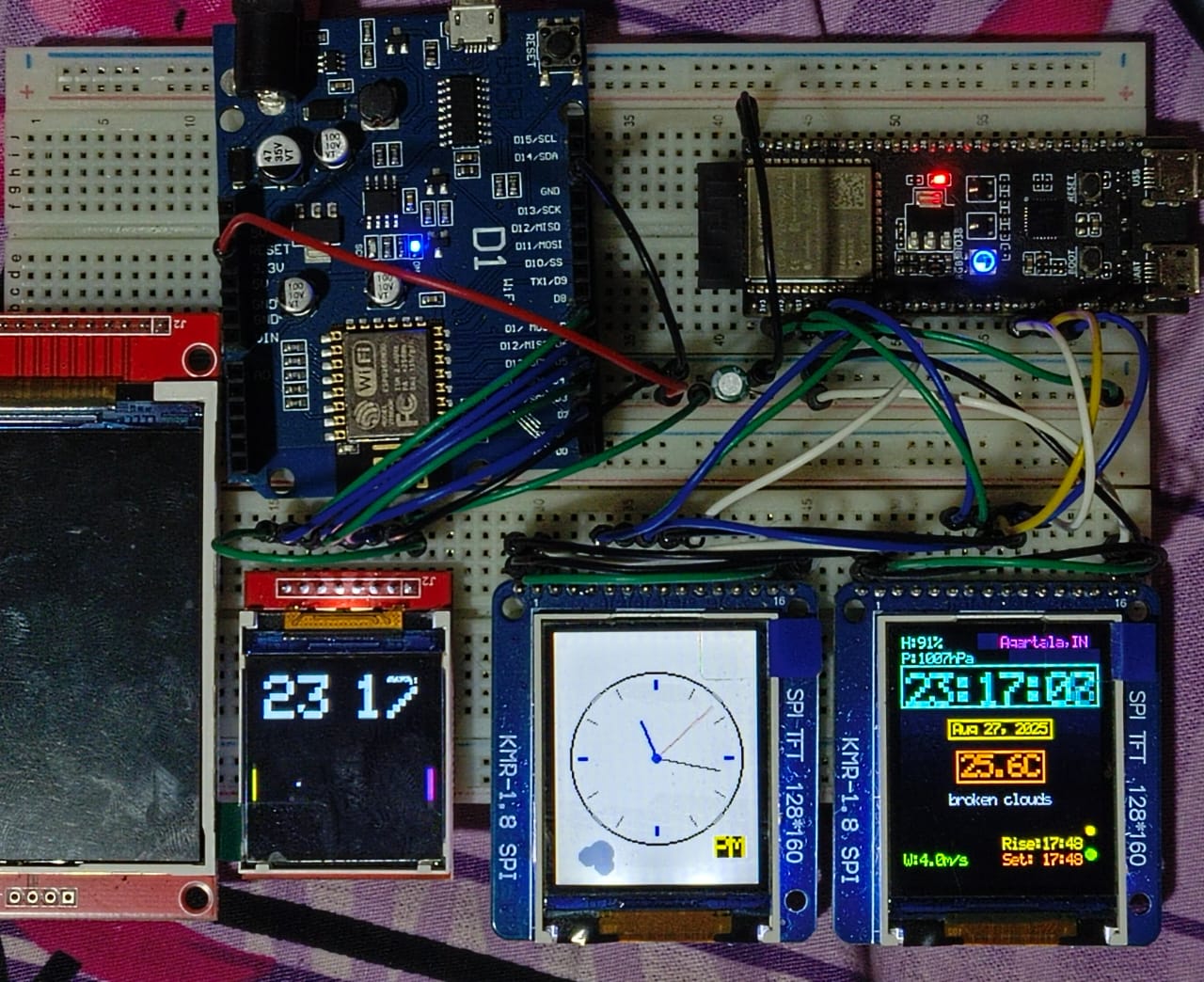

Hello everyone.

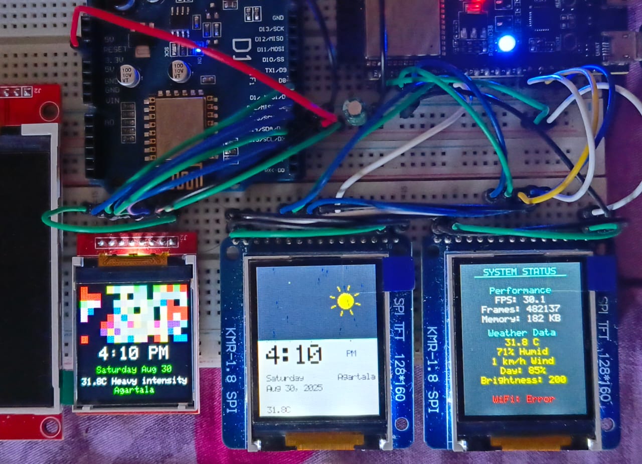

This will be my single unified thread to showcase all and any D1 R1 board projects using various display setup but with Adafruit Libraries. Only wet test passed firmware and projects will be uploaded here.
For the first one, I present:

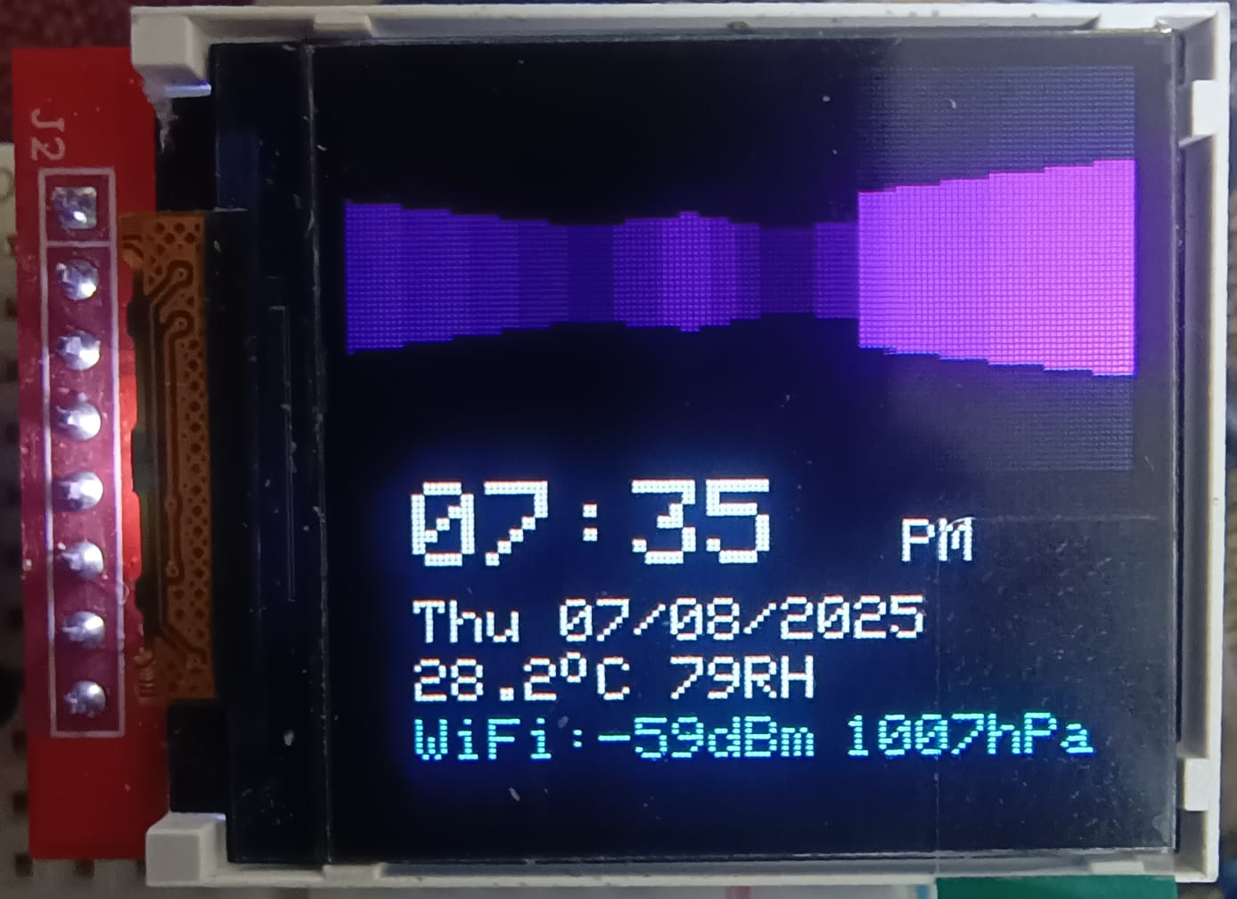

1.44 TFT Hyperclock Firmware Raycaster
A LOLIN/Wemos/NodeMCU D1 R1 ESP8266 1.44 SPI TFT 128*128 ST7735 (GREENTAB) Firmware which uses dedicated text and graphics display buffer to procedurally render a ray casted 2.5D visual as the clock animation loop.
Tested to run on D1 R1 for days uninterrupted without any issues.

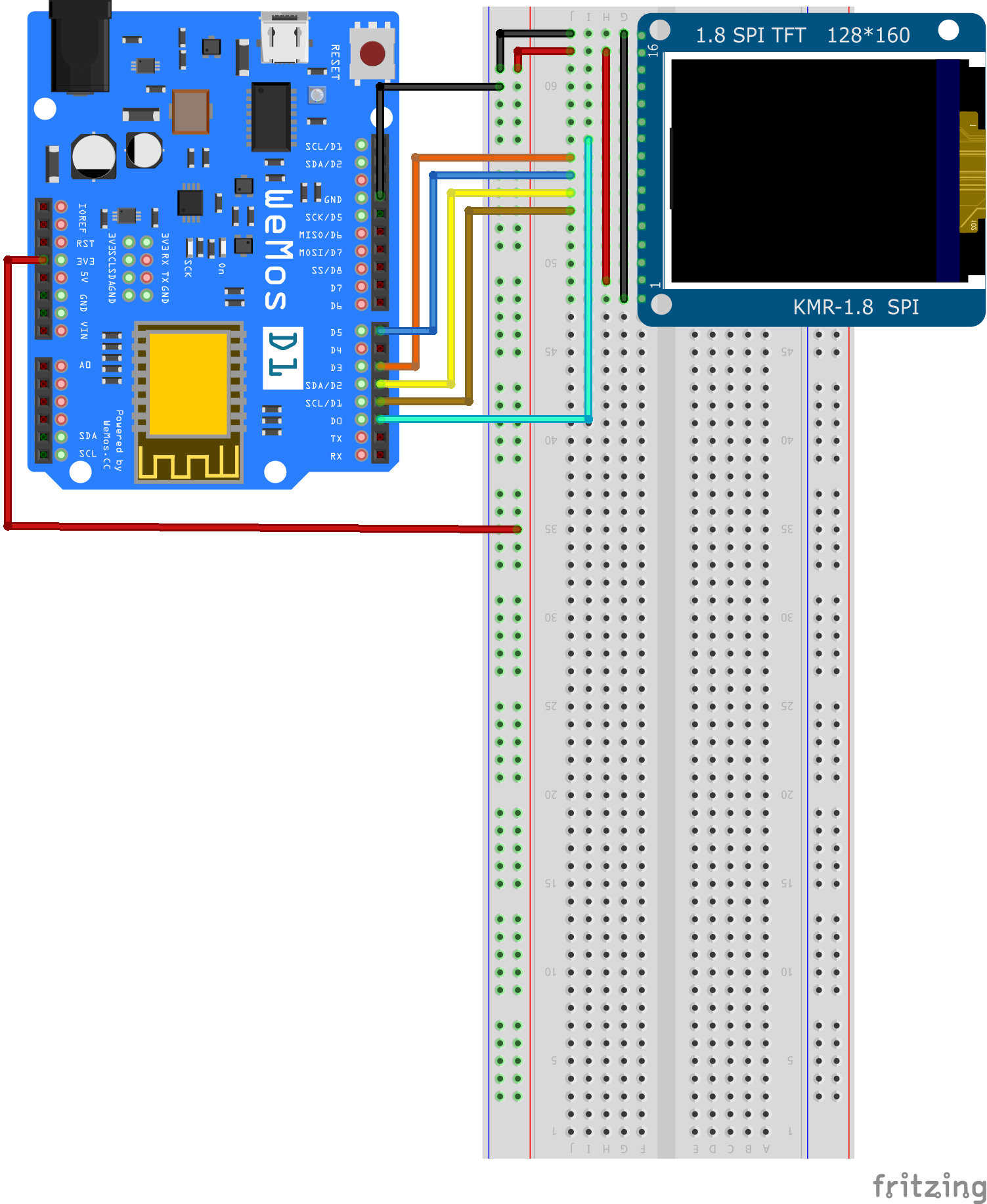

If the breadboard only contains the display and nothing else, the limiting resistor and the decoupling capacitor of the circuit/breadboard can be removed or not used. Ceramic capacitors are always recommended, use electrolytics only on unavailability of ceramics.
Alternate schematic is included in the commented header of the main sketch.
PS: The board present in the above Fritzing diagram is R2. But I have kept the physical positions of the Pin relevant to R1, which is the board on which the firmware has been tested. Kindly check the GPIO relevance if you have R2 version of the board.
The TFT shown here (in the fritzing export) is 128x160, the one I have used is 128*128 but by the same manufacturer. (The file itself has been provided by the manufacturer). So the pin definitions match perfectly (personally double checked). You can safely follow them.
Device info link:
1.44 128*128 SPI TFT ST7735
If your board is R1, follow the physical positions along with the red helper labels to be sure, and you are golden.
If your board is R2, refer to your datasheet for appropriate MOSI and SCK female slots.
Here are the R1 and R2 side by side for verification and reference. I will go ahead in the rest of the article assuming my hardware, which is R1.
Image source thread:
Image by Costas from blynk community.
Main sketch:

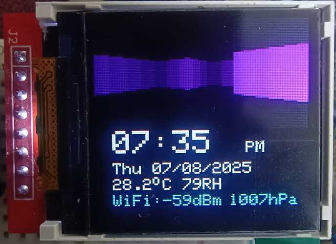

 * ESP8266 2.5D Raycasting Real-Time Clock with Weather Integration
 * Advanced Pseudo-3D Graphics Engine with Optimized Memory Management
 * Version: 2.5 Polished Edition Revision 2
 * Author: Sir Ronnie from Core1D Automation Labs
 * License: MIT License
 * Target: ESP8266 WeMos D1 R1 with 1.44" ST7735 SPI TFT Display (128x128)

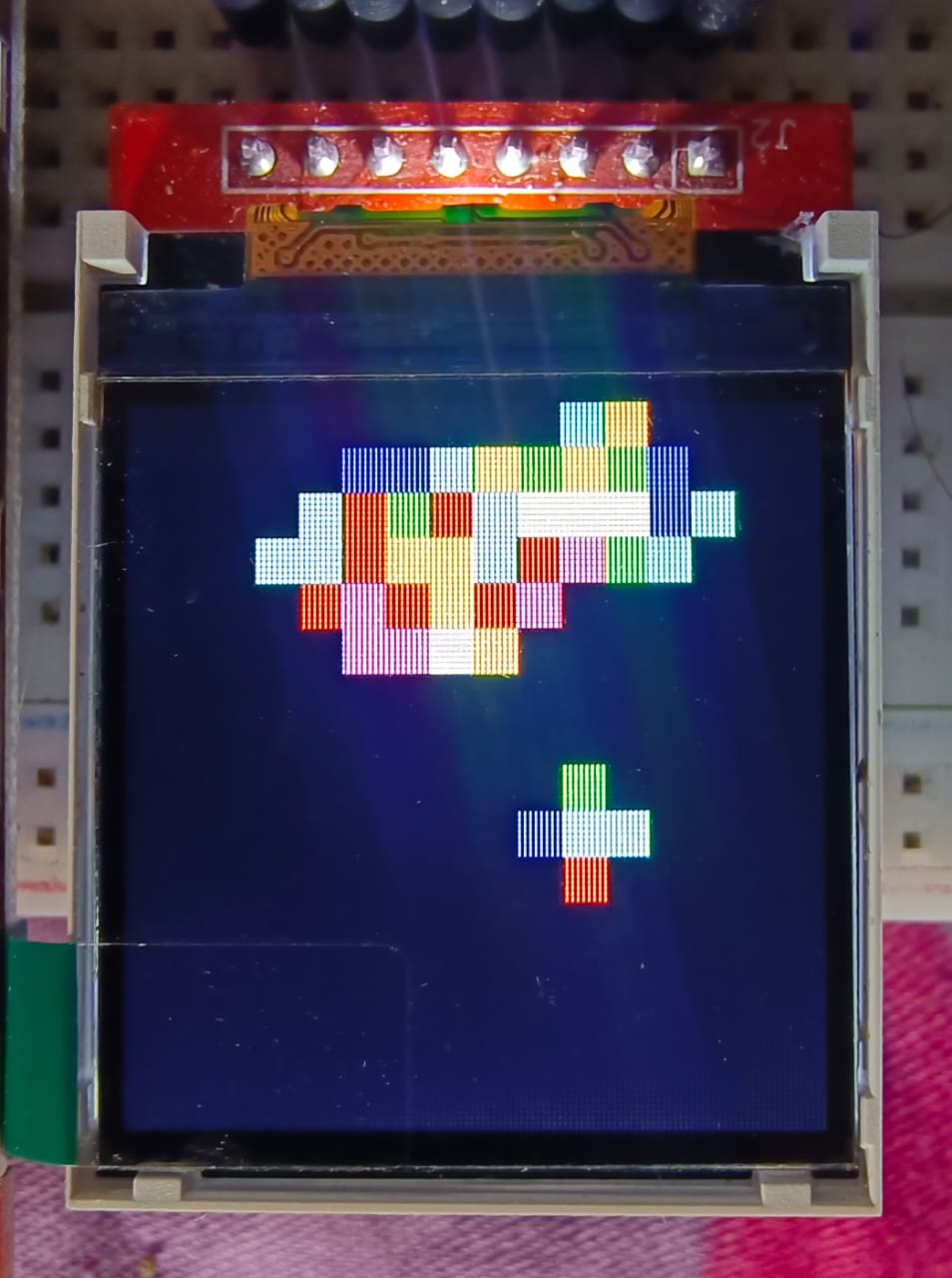

  // Add random patterns for perpetual interest
  for (int i = 0; i < 10; i++) {
    int rx = random(0, RENDER_WIDTH - 3);
    int ry = random(0, RENDER_HEIGHT - 3);
    addGlider(ry, rx);
  for (int i = 0; i < 5; i++) {
    int ry = random(0, RENDER_HEIGHT - 1);
    addBlinker(ry, rx);
  // Add some random cells for variety
  for (int y = 0; y < RENDER_HEIGHT; y++) {
    for (int x = 0; x < RENDER_WIDTH; x++) {
      if (random(0, 100) < INITIAL_ALIVE_CHANCE / 2) {  // Reduced random density since patterns added
        gol.current_grid[y][x] = true;
  gol.alive_color_index = 0;
  gol.last_generation = 0;
  gol.force_clock_redraw = false;
  // Clock bounds
  gol.clock_min_x = common.digits[0].x - 1;
  gol.clock_max_x = common.digits[3].x + DIGIT_WIDTH + 1;
  gol.clock_min_y = CLOCK_Y - 1;
  gol.clock_max_y = CLOCK_Y + DIGIT_HEIGHT + 1;

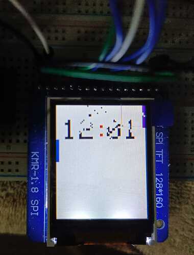

void initializePong() {
  // Initialize ball with momentum
  pong.ball_x = RENDER_WIDTH / 2;
  pong.ball_y = RENDER_HEIGHT / 2;
  pong.ball_vx = random(-100, 100) / 100.0f;
  pong.ball_vy = random(50, 150) / 100.0f;
  pong.old_ball_x = 0;
  pong.old_ball_y = 0;
  // Initialize paddles
  pong.left_paddle_y = RENDER_HEIGHT / 2;
  pong.right_paddle_y = RENDER_HEIGHT / 2;
  pong.left_paddle_target = RENDER_HEIGHT / 2;
  pong.right_paddle_target = RENDER_HEIGHT / 2;
  pong.old_left_paddle_y = RENDER_HEIGHT / 2;
  pong.old_right_paddle_y = RENDER_HEIGHT / 2;
  // Clear particles
  for (int i = 0; i < MAX_PARTICLES; i++) {
    pong.particles[i].active = false;
void initializeDigits() {

27/08/25 Edit:
Here is the 1.4 128x128 SPI TFT GREENTAB standard version of the same sketch:

// Add Conway patterns
void addConwayPatterns() {
  const uint8_t patternType = fastRandom() % 5;
  const uint8_t startX      = fastRandom() % (GRID_WIDTH - 6);
  const uint8_t startY      = fastRandom() % (GRID_HEIGHT - 6);
  switch (patternType) {
    case 0: // Glider
      setCellState(currentGrid, startX + 1, startY,     true);
      setCellState(currentGrid, startX + 2, startY + 1, true);
      setCellState(currentGrid, startX,     startY + 2, true);
      setCellState(currentGrid, startX + 1, startY + 2, true);
      setCellState(currentGrid, startX + 2, startY + 2, true);
    case 1: // Blinker
      setCellState(currentGrid, startX,     startY + 1, true);
      setCellState(currentGrid, startX + 1, startY + 1, true);
    case 2: // Block
      setCellState(currentGrid, startX,     startY,     true);
    case 3: // Toad
      setCellState(currentGrid, startX + 2, startY,     true);
      setCellState(currentGrid, startX + 3, startY,     true);
    case 4: // Random cluster
      for (uint8_t i = 0; i < 6; i++) {
        const uint8_t x = startX + (fastRandom() % 4);
        const uint8_t y = startY + (fastRandom() % 4);
        setCellState(currentGrid, x, y, true);
// Conway's Game of Life
void updateConway() {
  static uint16_t stagnationCounter = 0;
  static uint16_t lastLiveCells = 0;
  // Pre-compute neighbor counts
  memset(&sharedBuffer, 0, sizeof(sharedBuffer));
  for (uint8_t y = 0; y < GRID_HEIGHT; y++) {
    for (uint8_t x = 0; x < GRID_WIDTH; x++) {
      if (getCellState(currentGrid, x, y)) {
        for (int8_t dy = -1; dy <= 1; dy++) {
          for (int8_t dx = -1; dx <= 1; dx++) {
            if (dx == 0 && dy == 0) continue;
            const uint8_t nx = (x + dx + GRID_WIDTH) % GRID_WIDTH;
            const uint8_t ny = (y + dy + GRID_HEIGHT) % GRID_HEIGHT;
            sharedBuffer.neighborCount[coordToIndex(nx, ny)]++;
  // Apply Conway's rules
  memset(nextGrid, 0, GRID_BYTES);
  uint16_t liveCells = 0;
      const uint8_t neighbors = sharedBuffer.neighborCount[coordToIndex(x, y)];
      const     bool    alive = getCellState(currentGrid, x, y);
      const     bool newState = alive ? (neighbors == 2 || neighbors == 3) : (neighbors == 3);
      if (newState) {
        setCellState(nextGrid, x, y, true);
        liveCells++;
  // Check for stagnation
  if (liveCells == lastLiveCells) {
    stagnationCounter++;
  if (stagnationCounter > 8 || liveCells < 5) {
    addConwayPatterns();
  lastLiveCells = liveCells;
  memcpy(currentGrid, nextGrid, GRID_BYTES);
