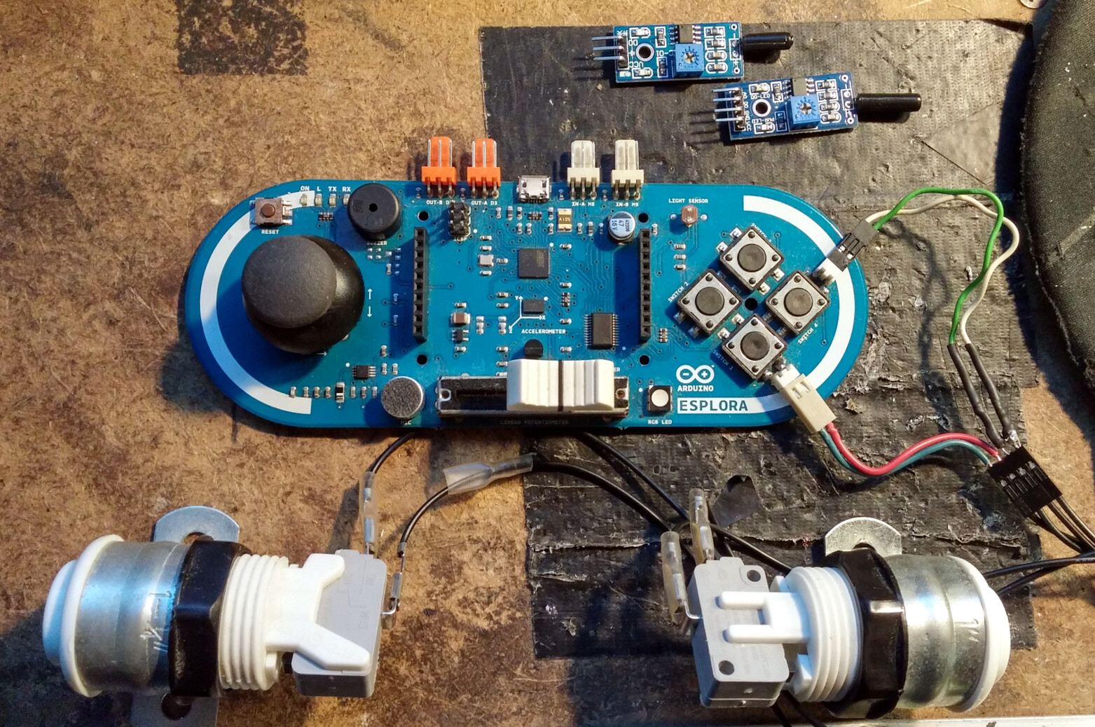

I'm currently working on upgrading the very unconventional input setup I've made for my video pinball table. Currently it consists of an Arduino Esplora and 2 flipper buttons with "high use" mechanical switches that I soldered to the buttons. At this time I was a total newb and had no idea if I could use the tinkerkit inputs or not for the flippers.
Now in the pic I uploaded, you can see 2 tilt switches, one with 3 pins and the other with 4 (analog/digital) that I bought to take place of a physical tilt. Only one will be used, they were very cheap so I got one of each just in case. Right now, tilting is mapped to the joystick left, right and up. Joystick down is the plunger.
So basically, what I'm getting at is, what would be the best way to clean this mess up? Should I just keep it this way and somehow map the tilt sensors to the joystick via the tinkerkit inputs? Or would the built-in Accelerometer be of some use? Also, I have few Leonardo's laying around that I can use.

The code currently used is a modified EsploraKart.ino
