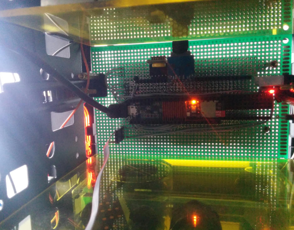

Setup: NHD 4.3" + Teensy 3.6 + microSD sandisk extreme 32 Gb on SDIO

Awesome setup btw
