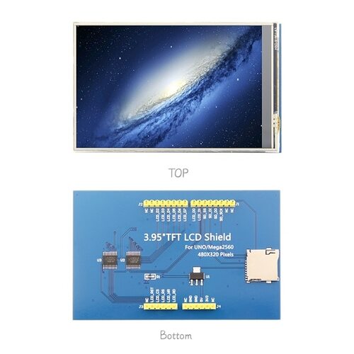

this link is a alternate option for you:
its large size with good resolution and works with mcufriend lib

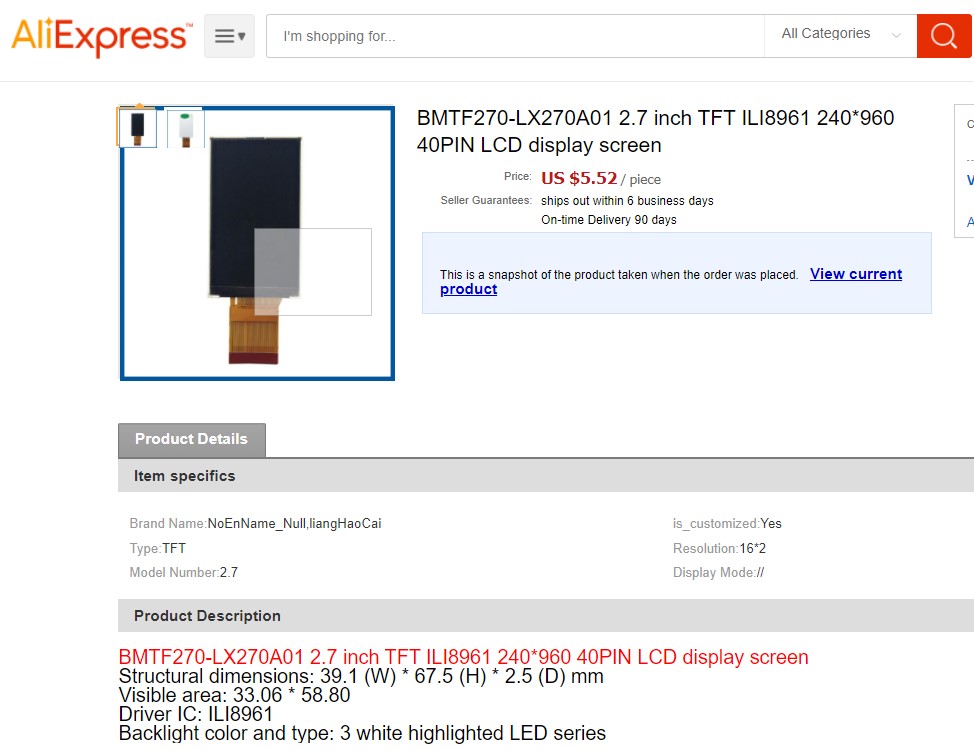

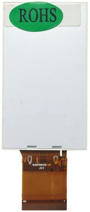

2.7 inch 40P 16M SPI RGB TFT LCD Screen ILI8961 Drive IC 960*240 HHT270C-8961-6A6 TXD270C-8961-6A6 JY2707C-8961-6A6

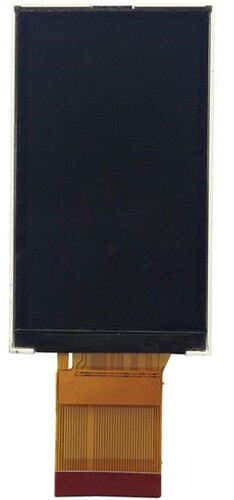

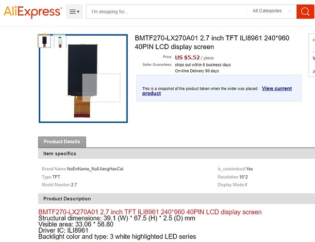

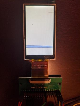

The lcd display I ordered is no longer available on AliExpress. I am attaching images cached from my order. It is similar to the maithoga branded one in Jean-Marc's post above.
(Update: you can find the display on AliExpress if you search for the item: BMTF270, or full model BMTF270-LX270A01).

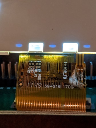

I am also attaching pictures of the flexible connector. The odd melting on the connector was there when it arrived, and makes me wonder if the lcd is really brand new (or a "correction" made at the factory). I ordered a breakout board with a connector for the 40 pin flex cable to make life easier.
I applied 3.7 volts to the the backlight anode pin with no results until the voltage was raised to between 8-9v. As the second attached image shows, there's also an odd blue line across the display. Question: if/when this works, is there a "boost" pin that can be used to supply voltage for the backlight? (I saw this on schematics for similar ILI8961 screens). I don't understand why on 3.7v circuits the LEDs are driven by 9volts.

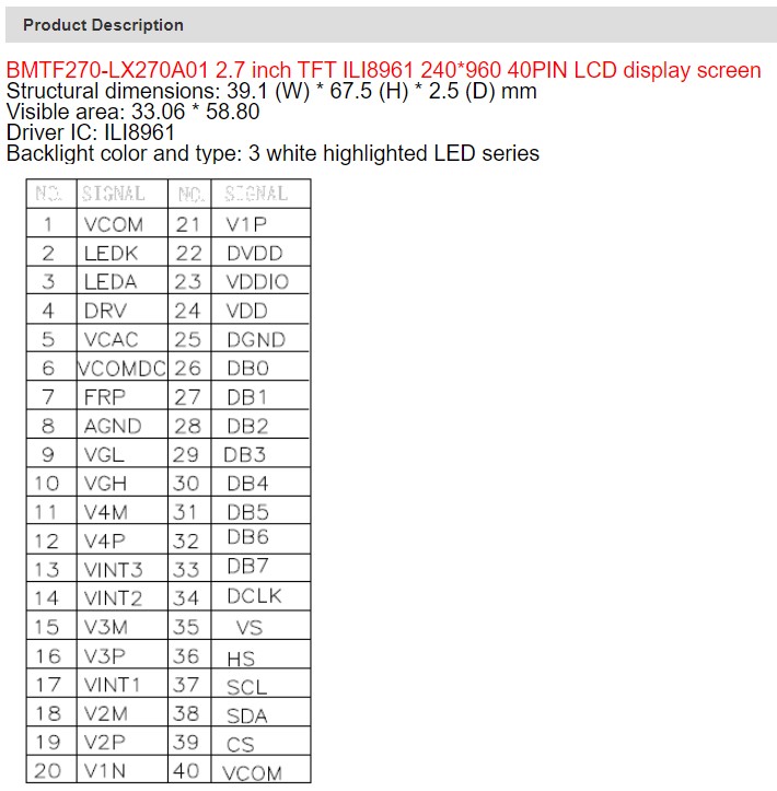

Another question (of many): the smaller displays for the Arduino's usually have separate pins for SDA/MOSI and AO/DC. I see SDA in the 8961 pinout spec, but no (single) data command line; just the parallel connections @David_Prentice mentioned. Why have a serial SPI interface AND still require all the parallel lines?

@msimon2020,
You should get more detailed answers from David Prentice, I hope.
The blue line on the protective foil of your display most likely means it didn't pass some quality criterion.
Someone retrieved it from the waste bin and passed it on to someone who tried to repair/re-use it.
Maybe a defective capacitor was removed. There are shops that sell such devices.
If you buy this display or a variant of it from Ruijia Industry / Maithoga / Ecyberspaces, you can ask for driver sources. You get a big zip-file with many driver sources, with one for your display, hopefully. These are C headers and C code. You can retrieve the initialization code and adapt an existing (ILIxxx) Arduino library.
Jean-Marc
@ZinggJM,
Thank you for your response. I had my suspicions after looking at the connector. I'm going to reach out to the vendor.
Mark
If I look at this spec, I don't see any GRAM (graphics RAM), so it would be hard to use.
The SPI serial interface seems to be 16 bits, containing control- address- and data-bits.
