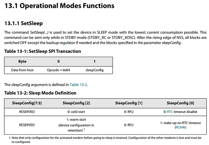

I'm struggling to understand how to set LoRa in a sleep state, so I ask for your help.
I use an ESP32 WROOM as MCU
In datasheet it can be set to SLEEP mode to 600 nA or 1.2 uA
How is this possible, what connections to make between LoRa and MCU?
And what command to use in IDE to enable/disable sleep?
Thanks up front!
Well, its in the data sheet, you connect the LoRa module up with its SPI interface and write the sleep command as two bytes;
And yes the sleep current is under 1uA.
Normally however, the LoRa library you are using will have a built in sleep function something like this maybe;
LoRa.sleep();
Which LoRa library are you using, it would need to be one that supports SX126X devices, some of the common LoRa libraries are only for the SX127X.

Puting the ESP32 into sleep and the LoRa module into sleep are two different things.
So you have an SX1262 as the sender and a SX1278 as the receiver ?

That code, not that I have tried it, looks like it puts the SX126X into receive mode, then the ESP32 into deep sleep mode ready to wake up when a packet arrives.
Do remember that when an ESP32 comes from deep sleep its as if it has been reset or just powered up, care with code needed to avoid clearing the received packet from the LoRa module.
The LoRa module in RX mode will consume circa 7mA, so why not just put the ESP32 in light sleep mode, code should be much easier.
