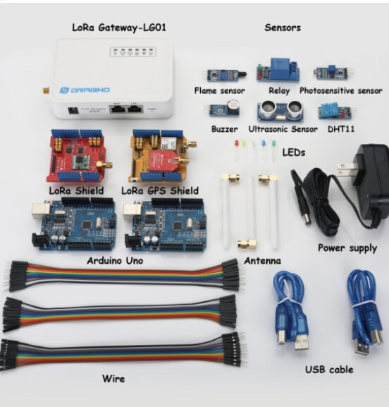

If I want to use the lora shield and that will be the main bulk of where my IO devices will be connected, the available pins i will have is around 10 if I am not wrong.
I am using 2 pins for 2 servo motors(SG90 9G), 2-4 for the LCD(RG1602A) display and 1 for the IR Sensor(HW-201).
I would like some opinions on what I am doing if possible.
As for the hardware I am planning on designing it myself.
have you already purchased the modules in the photo of post 1 or are you planning to design and implement a custom PCB
you show two LoRa shields and a LoRaWAN gateway - are you planning to use LoRaWAN or LoRa point-to-point?

what LoRaWAN service are you communicating with?
LoRa has restrictions on traffic - see LoRa fair-use-policy-explained
using LoRaWAN I typically send a small packet, e.g. 8 bytes, every 10 minutes to The Things V3 sever
if you need faster communication have you considered WiFi (assuming your project has WiFi coverage)
perhaps more details on the overall aim of the project would help, e.g. a requirements specification
So I have already built up 2 servers, the chirpstack network server and the thingsboard community application server.
Both of them are FOC. I just need to build 2 server on 2 ip address.
According to heltec board that I am using since it is a esp32 so the lora data payload is able to go up to 64 byte.
and the uplink and downlink is every 1 second since it takes time to send the data up and down.
the problem i have is right now the data is not being sent to my network server as fast as I wanted it to and it skips the process of data recording. and I cannot visualize the data on something like a thingsboard
Have you ever faced a situation where the data payload is not able to be sent to a network server because another actuator have been activated. so although my sensors and the servo motor is working as intended the data is not being recorded so there is no way for remote monitoring.
@horace do you have experience with using lorawan with esp32?
I have used LoRaWAN on ESP32s connected to RFM95W and RA-02 modules also ESP32 PCBs with integrated LoRa devices such as the Heltec wifi-lora-32-v3
I tend to use LoRaWAN to the Things V3 server - which server do you use?
also used LoRa point-to-point for local communications
looking at the photo in post 1 it looks like you are using UNOs with LoRa shields
I was told that arduino uno takes up too much power and recommended using esp32 so I ended up using esp32 heltec lora32 board.
The servers that i use is as shown
esp32--> chirpstack network server --> thingsboard server
