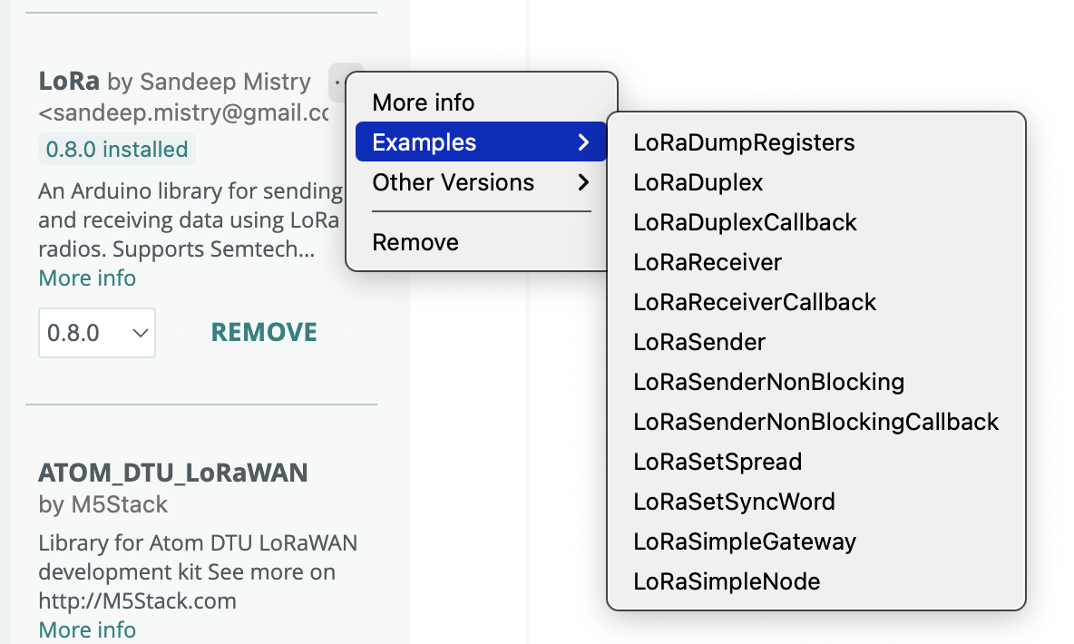

Here is a good library, I did a screen grab of the sample code. You can use a sender in one and a receiver in the other unless you need two way then the duplex.

Thank you, I tried the example; monitor only displays Lora Sender over and over; not Hello Do i have to tweak the example code somehow
Which example is that, it isn't correct.
