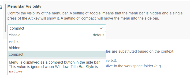

Hi @docdoc. Try this:
  1. Press the Ctrl+Shift+P keyboard shortcut (Command+Shift+P for macOS users) to open the "Command Palette".
    A menu will appear on the editor toolbar:
  2. Select the "Preferences: Open Settings (UI)" command from the menu.
    You can scroll down through the list of commands to find it or type the name in the field.
    A "Preferences" tab will open in the Arduino IDE main panel.
  3. Type window.menuBarVisibility in the "Search Settings" field of the "Preferences" tab.
  4. Select "classic" from the menu under the "Window: Menu Bar Visibility" setting.
  5. Close the Preferences tab by clicking its X icon.
Hopefully that will restore the IDE back to the normal layout.
Thanks, I can gain my topbar menu back, but IMHO there's still something to investigate about that.
My "Menu Bar Visibility" was in fact set to "compact" (meaning it shows just the "hamburger" button instead) and the "Title Bar Style" was "native". But, based on the tooltip of "Menu Bar Visibility" setting:
the "compact" will/should be ignored when Title Bar Style is "native", and IMHO it should mean Menu Bar behaviour is the default ("classic") one. But first of all it doensn't: with "Menu Bar Visibility"="compact" and "Title Bar Style"="native" the Menu Bar is hidden (while the "hamburger" button is correctly shown). But then, if I press F11 twice the Menu Bar shows back (if the setting should always hide Menu Bar it shouldn't show up, or if the setting brings to "classic" it should show up without F11).
Do I miss something?
