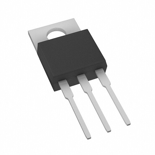

I'd like to control a USB smartphone charger electronically. I've found a schematic from an old thread, but it uses a MOSFET in an SMD package. Is there any equivalent MOSFET with a low RDS(on) - about 50 milliohms - in a "bigger" package (I don't know how to say it better)? Thank you.
A through hole part is what you want.
Here is one:

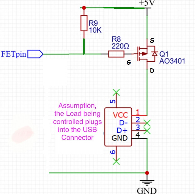

The schematic.
from @LarryD

FYI:
That schematic is wrong.
Q1 upside down for a start.
10K should be to +5V.
Is the MOSFET logic level?
Gnd the FETpin turns on Q1.
PS. Using pin designators helps a great deal.
@TomGeorge, thank you very much for fixing the schematic! I assumed that the schematic was correct because there were no further replies (and I hadn't noticed that the last reply fixed the orientation of Q1).
Do you think that I could drive FETpin with an output pin of an Arduino board powered by the same 5 Vdc? Actually, I'd power everything with the same smartphone charger whose output the circuit is controlling.

If it was just a plain old 5V power adapter, then switching the VUSB voltage will work,
If it's some kind of "smart" charger then it probably won't work since they also use the data signals and just switching VUSB will cause problems.
With USB-C it even more complicated.
Wait a second! The USB-C end connects to the phone, but the other end of the cable is USB-A, which I could wire instead. Still, as you pointed out, simply cutting the voltage won’t do the trick, so it’s clear I’d better use a dedicated IC for the job. Now that I think about it, if soldering the SMD IC proves too tricky, I could always outsource it to a professional electronics lab. Thanks again for your help!
