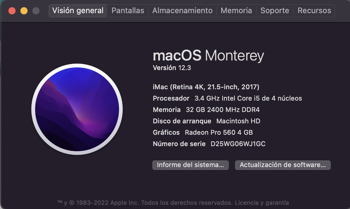

I updated to mac os 12.3 yesterday. Now, when I "verify" sketch with ESP32 board, I get error
