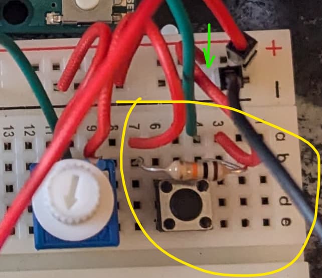

I think I worked out those bits^. The code uploaded fine, but the button doesn't change the screen. I guess I have it in the wrong place on the breadboard perhaps? It positioned at 4c, 4e, 6c, 6e. The lead is going from 4 on the Bboard to the 6 digital pin. I have a resistor at 4b, 7b. I can try sending a pic is that's better.
p.s apologies for my incompetence, again, I have no idea what I'm doing.

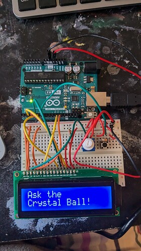

Hiya, still no change to the lcd when I push the button. It stays displaying 'ask the crystal ball'
This is what I'm working with:
I suggest you to check the button connections.
  1. Once you have pin 6 in INPUT_PULLUP mode, the button should connect one leg to GND and the other to pin 6, no need for a resistor. Because of the angle of the photo and all wires being red, I wasn't able to identify wether it's connected to (-) or (+) line.
  2. these buttons can be tricky due to their square form. The safest is to use 2 diagonal legs instead of 2 legs of the same side.
PS: red wire with the green arrow seems to connect (+) to nothing, so it's unecessary...
