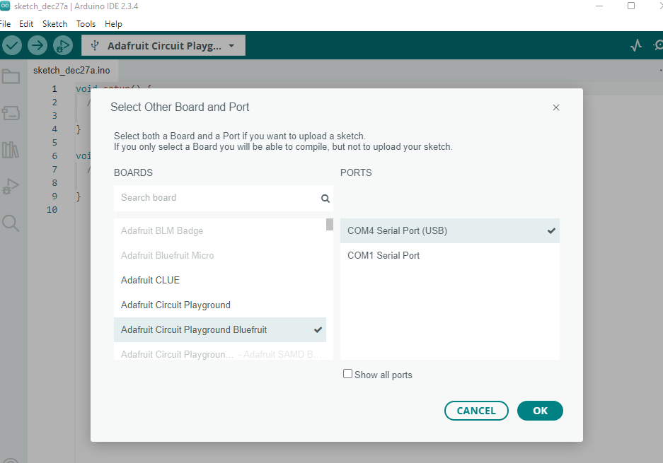

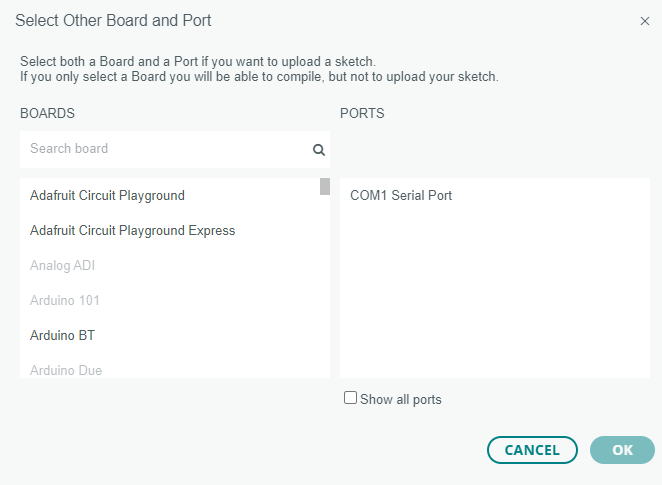

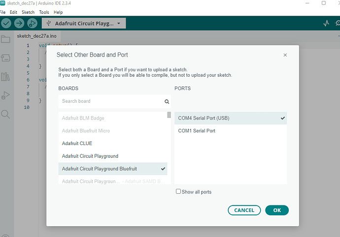

And one thing I did notice with Arduino IDE, "Circuit Playground Bluefruit" isn't on the list so is that because it's compatible with the "Adafruit Circuit Playground" on the list or am I missing the Bluefruit playground drivers/files?
Thanks again :bowing_man:
No. Despite the similar names, there are very significant technical differences between the three boards.
The Circuit Playground Classic board (referred to as Circuit Playground in the Arduino IDE boards list) uses the Microchip (née Atmel) ATmega32U4 microcontroller. The Circuit Playground Express board uses the Microchip ATSAMD21 microcontroller. The Circuit Playground Bluefruit board uses the Nordic nRF52840 microcontroller. Each of these boards use a different compilation configuration and upload mechanism.
Yes. Follow the instructions here to install support for the Circuit Playground Bluefruit board in Arduino IDE:
thank you...
