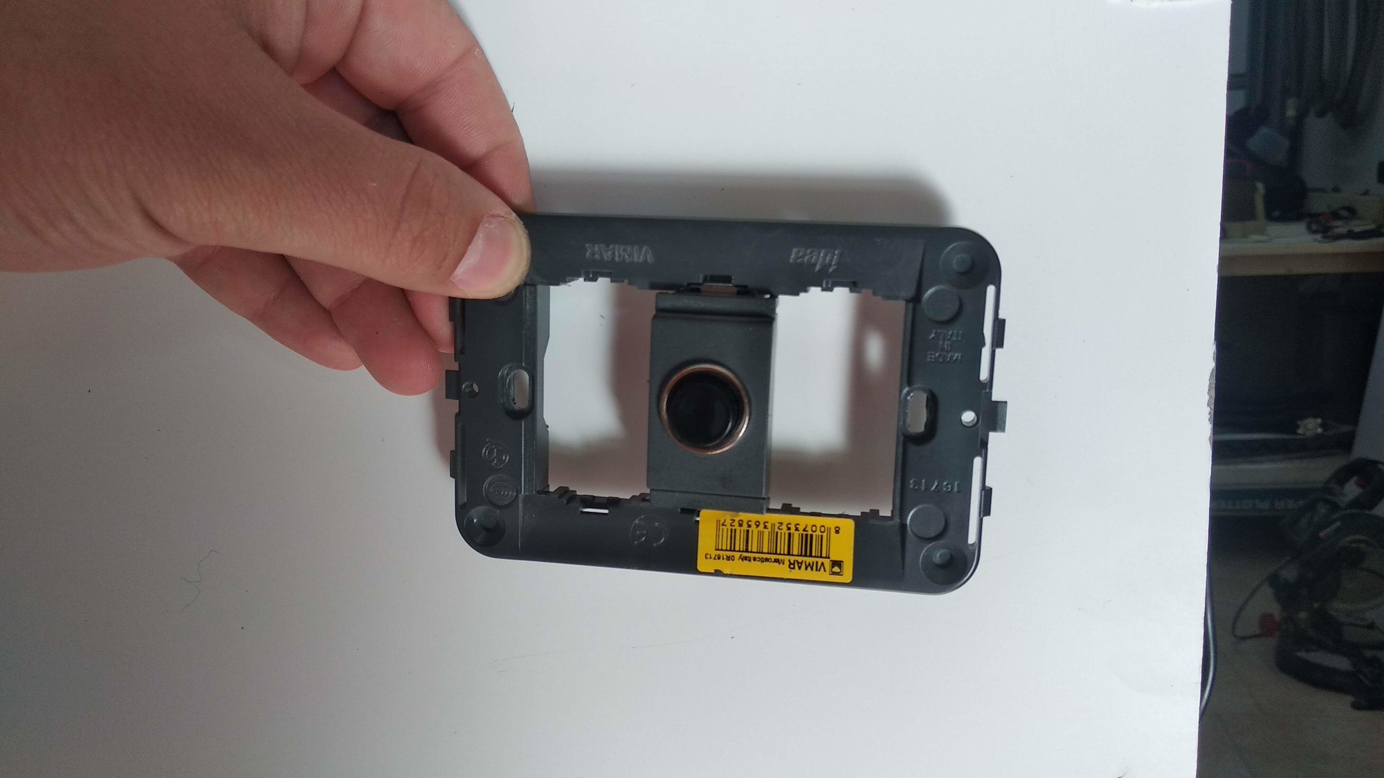

some pics:
The schematic is essentially/electrically the same as before.
Just moved things around and relabeled things a bit.
