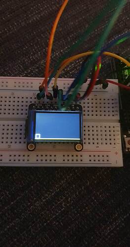

Hello,
I was wondering if anyone had any advice on making an object move forward and backwards using buttons or joystick. I just dont know how to connect with the object.
This is the code, i know i have no controller yet.

to move the object, gather the new position from your input device, erase the previous position and draw at the new position. rinse and repeat
By "object" did you mean that little rectangle?
tft.drawRect(3, 3, 20, 20, ST7735_WHITE);
You don't have any code in your sketch for working with the buttons. I would start with getting that working in your sketch first. But if you want to redraw the object, just fill the screen with your background color (black), then draw the object in the new location you want it. So, if your first draw is
and you want to move it to the right 5 pixels you would modify it to
tft.drawRect(8, 3, 20, 20, ST7735_WHITE);
The sketch you have uploaded looks like the demo sketch. So, do you understand how it works?
