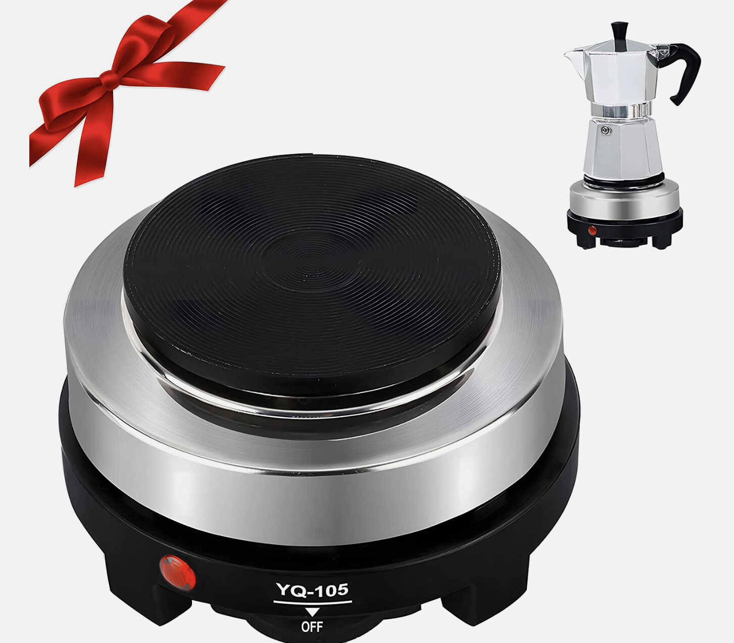

  • Do you know what a relay is ?
  • Maybe make it simple and just use the Arduino as a timer the can turn the unit on/off/warm and alarm when time is up. :thinking:
I think that could work, but I would still like to have a a vending machine feel. Also, I do know what a relay is but how would I wire that up to a 2/3-pin wall plug? Maybe I could wire up the tea heater with a relay and turn it off when it gets the right temp?
Thanks!
