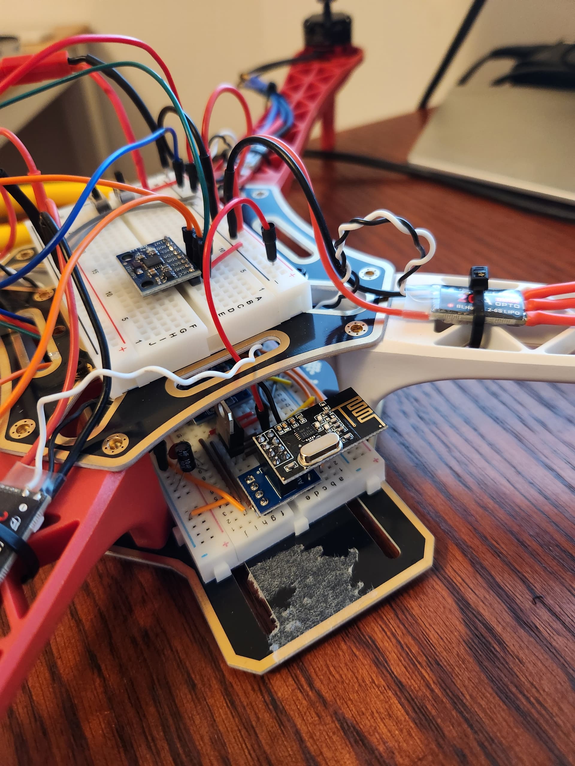

Hello I recently built a Nano+nrf2401 transmitter and Nano+nrf2401 receiver to use on a quadcopter drone. The joystick trimpot data is transmitted to the receiver using a structure of bytes to hold the various data points from transmitter. The transmitter code is below

Right now I have only been playing with the top left motor data just to make sure I'm transmitting and receiving correctly. On the receive side, I use the map function to map joystick 1 y-axis byte data to a pwm throttle number from 1000-2000 that the motor ESC will understand. It works great but after doing this I noticed the variable I use to store the mapped ESC data (TopLeft_pwmVal) is an int and the joystick data is a byte. My question is does the map() function take any input data type and transform it to the data type you chose? In my case I declared TopLeft_pwmVal an int
int TopLeft_pwmVal, BottomLeft_pwmVal, BottomRight_pwmVal, TopRight_pwmVal;
then I called map() in the following way
TopLeft_pwmVal = map(data.j1PotY,0,255,1000,2000); //Map left joystick y coordinate (0-255) byte to int value (1000-2000)
The documentation on map() says it returns a long. Also is long still considered an integer even though int is 16 bits and long is 32 bits?
