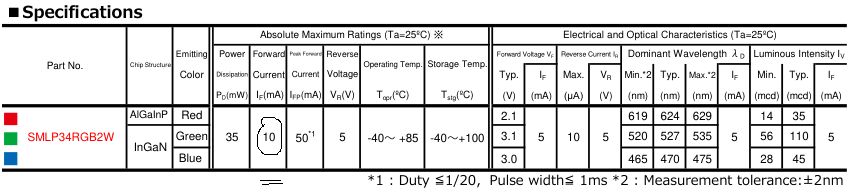

The maximum current of the DL1 LED is 10 mA. What happens if you set the outputs OUT1, OUT2, OUT3 max current to 40 mA (Current Band Register 03h from the datasheet IS31FL3194)? Will the LED fail?

The LEDs are not connected to the pins of the Arduino port, but are connected to the U8 driver chip, which provides a current of 40 mA.
The LED's will draw infinite current without series limiting resistors! Both the Arduino AND the LED's will literally smoke.
The Arduino will not smoke, because inside the U8 driver there is a 10-20-40 mA current limiter. But the LED can smoke. Is this a mistake by the Arduino developers?

Yes it seems like there are restrictions to the maximum current from the driver's data sheet. See this part of the data sheet:-
Normal everyday 5mm LEDs are specified as 20mA normal working, so if you set another level greater that this you will exceed this rating.

You did not understand me. This is not my schematics, but part of the Arduino Nicla Voice schematics (see below). LED DL1 is tricolor SMD. Its maximum current per R, G, B is 10 mA (see below-below). This is the absolute maximum that the manufacturer prohibits exceeding. Again my question - is this a fault of the schematics developers of Arduino Nicla Voice?

It is a schematic you posted therefore it is your schematic. You are responsible for posting a partial schematic. It is missing pull up resistors on the I2C lines. If there are no pull up resistors in the whole circuit then indeed the people who drew that schematic are in error. However, I would guess that they knew what they were doing.

The topic of this forum thread is "Hardware-Nicla family-Nicla Voice". This means that the questions relate to the schematics of this particular Arduino board [https://docs.arduino.cc/static/521d17d385eae16237b35c3c17c95cd7/ABX00061-schematics.pdf]. Load resistors for I2C are located in the schematics Nicla Voice, there are no questions about them.

The answer to your original question in post 1 is YES.
