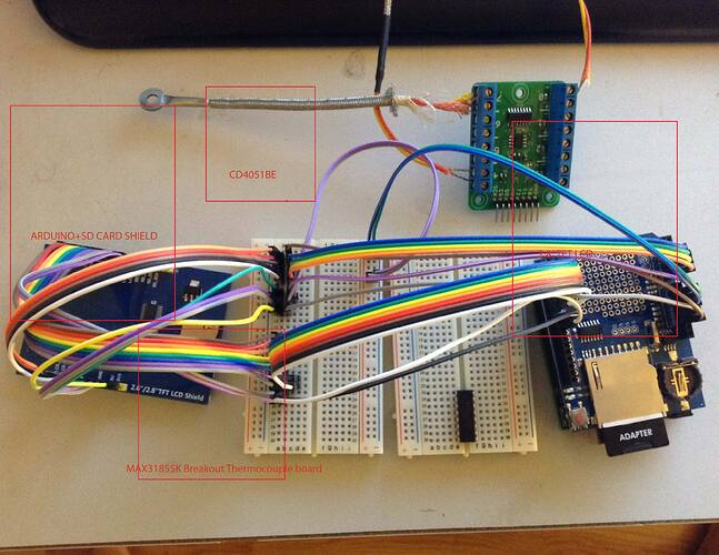

Current Status:
2.8" TFT LCD is hooked up with Arduino UNO
SD CARD Shield is mounted on Arduino UNO (but code is not currently using it. I will
do this part last.)
On my Arduino UNO:
Pins 2, 3,4,5,6,7 - connected to 2.8"TFT LCD
Analog Pins A0, A1,A2,A3 - Connected to 2.8" TFT LCD
Pins 10,11,12,13 - Vacant (Since I am not using 2.8"TFT LCD SD CARD)
Pins A4, A5 - Vacant
Questions:
  1. Connecting CD4051BE to Arduino UNO : From datasheet, following was the conclusion:
Connect 9 , 10 , 11 pins of CD4051BE to 10,11,12 on Arduino UNO
Connect VCC to VCC and GND to GND
Connect Pin 3 to A4
  1. Connecting MAX31855K Breakout Thermocouple Board
There are 8 pins on MAX31855K Breakout Board: GND T0 T1 T2 +V SO CS SCK
How should I connect MAX31855K to CD4051BE
  1. Coding and Communication : Once I connect MAX31855K to CD4051BE, in my code how should I define the 8 pins (GND T0 T1 T2 +V SO CS SCK)?
    Before when I used to hook up the MAX31855K to Arduino, I just defined 8pins by pin number on Arduino.
  2. Also I need to hook up two relays. After using CD4051BE I have only one digital pin and analog pin left, Pin 13 and A5 respectively.
    I will be able to hook upand connect relay on 2nd CD4051BE?
You provided a lot of information but omitted a schematic. A review of your post reveals you think you should connect the CD4051 power connections to the arduino UNO Vcc (There is NO pin on the arduino UNO labeled Vcc) I know what you meant, but you have to state it explicitly using the given labels on the UNO . This may present a problem . The Max31855 breakout bd has Vin and 3V in. The adafruit site says it is 3.3V to 5V compliant, which seems to imply that the pins are 5V tolerant even though it is a 3.3V device and the only place you can connect 5V to it is the Vin pin (because it's an LDO regulator).
If the CD4051 is running on 5V, it should still accept 3.3V level signals from the 31855 bd. If that doesn't work you can add a CD4050 buffer chip running on 5V and it will do the level translation.
I guess my only question is WHY do you think you need a CD4051 (an analog mux) connected to a breakout board with digital input/outputs ?
That makes no sense at all. Please explain.
Also, I saw no mention of the thermocouple connections .
The 31855 is an 8 TC bd
but STILL is DIGITAL, NOT ANALOG.
SO WHY THE CD4051 ?
That chip is an ANALOG MUX, NOT digital.
What's up ?
What is your electronics background ?
Do you have circuit design experience ?
Have you read any datasheets ?
Hi raschemmel
Sorry about schematic and information I skipped. I will post it as soon as possible. This was my first post and I tried to give as much information as I can, unfortunately I missed some.
And yes, MAX31855K is 8 Thermocouple board.
My initial plan was to use 74HC595 shift out register. So, by connecting MAX31855K to 74HC595 and 74HC595 to Arduino UNO.
But I was not sure if this would have worked.
I should have asked this question first before heading to 4051.
To answer your questions:
"I guess my only question is WHY do you think you need a CD4051 (an analog mux) connected to a breakout board with digital input/outputs ?"
First question I asked myself, Can analog inputs be used as a digital pins?
Reading the below article:
I found yes.
Also , on datasheet: http://www.ti.com.cn/cn/lit/ds/symlink/cd4051b.pdf
They mentioned it can be used for Analog and Digital Multiplexing.
So why can't I provide digital signal to it?
My background is Mechanical Engineering with 1 electronic class in school which I failed twice.
I have never played with IC before. This is the first time I using 74HC595 and CD4051BE.
I could have used Arduino Mega and done with it. But I wanted to learn about multiplexers for a long time now. I know I am going to make mistakes, but it is worth it.
May be CD4051 can be used here. May be you are right. But why it cannot be used?
On the MAX31855K Breakout board, they are using 74HC4051D chip and still supplying digital signal to it. arent they?
If CD4051 would not work,
Would I be able to use 74HC595?
If not, what would you use to get it working? I am out of pins by using tft lcd.
I think you are confused Arduino analog inputs most definitely can be used as digital because the ATmega328 switches between the analog circuit or the digital circuit. The CD4051 is NOT a DUGITAL MUX, PERIOD.
Yes you are absolutely correct! It cannot be used.
Do you think 74HC595 will work though?
I don't know how. Do you have any code for the 31855:?

Suppose I have defined all output pins on 74HC595.
D0
D1
D2
D3
D4
D5
D6
D7
Wouldn't I be able to define these pins to MAX31855K Octo Thermocouple board pins?
GND - D0
T0 - D1
T1 - D2
T2 - D3
+V - D4
Now as per logic chart printed behind the board:
T2 T1 T0 THERM
L L L 0
L L H 1
L H L 2
L H H 3
H L L 4
H L H 5
H H L 6
H H H 7
Wouldn't I be able to digitalwrite(T2 , High)
digitalwrite(T1, High)
digital write( T0 High) ?
So, That is what I thought.
the other question is where would I connect SCK, CS and CO pins on Breakout board to? I am not sure how would I read temperatures as 595 is sending output signals.
Can I connect SCK, CS, and CO to ICSP header?
What I mean is T0 & T1 are the thermocouple connections , not the arduino connections and thermociuples are not compatible with digital signals.
Post a photo of hand drawn schematic.
That's stupid. Those are ADDRESS lines !
They should be labeled A0,A1 & A2 !
(NOT T0, T1 , & T2 !)
I think you can forget abiut using the 595.
That isn't going to work because the data is a packet, not individual bits. The 595;is a horse in a dog show.
No you CAN'T.
All I know is, Octo Thermocouple MAX31855K Breakout Board has a 74HC4051 and MAX31855K on it.
You can connect 8 k-type thermocouples to this board. and The 8 pins I mentioned before is connected on DigitalI/O pins.
I don't know how T0, T1 T2 are able to take digital signals.
I usually plug to analog inputs. But this was different.
I have attached the picture between ARduino and Octo thermocouple MAX31855K Breakout board .
And I am working on schematic for Arduino, LCD, 74HC595 and Octo thermocouple MAX31855K Breakout board using fritzing. I am half way there.
You said you already tested it so what's the issue ?
(besides the fact you can't use a 595)
There's no mystery about the onboard 4051
but that has nothing to do with you and you should forget that you know that because it is NOT there for you to use. It is the MUX used MUX the voltages to the onboard ADC.
WHY ( on earth) would you connect GND to D0 ?
WHAT ( on earth) is C0 ?
D0
D1
D2
D3
D4
D5
D6
D7
GND - D0
T0 - D1
T1 - D2
T2 - D3
+V - D4
No. You can't connect the GND to a digital pin.
And you can't connect +V to a digital pin.
I don't know where you are getting these crazy ideas but stop it.
http://i.ebayimg.com/images/g/yyMAAOSw1vlUwIGW/s-l1600.jpg
T2 T1 T0 THERM
L L L 0
L L H 1
L H L 2
L H H 3
H L L 4
H L H 5
H H L 6
H H H 7
Yes, if you want to select TC #7.
t
The other question is where would I connect SCK, CS and CO SO pins on Breakout board to?
There is no "C0"
It's "SO". (for Serial Out)
You can't use the 595.
Can I connect SCK, CS, and CO SO to ICSP header?
Only if your code expects them to be there.
I guess my best option is going with Arduino Mega then.
Thanks for your help raschemmel.
It should be obvious that a SPI interface is digital and not analog so the 4051 couldn't possibly connected to the "outside world". ( with the exceotion of the thermociuples)
I don't see how a Mega would help with serial SPI interface
