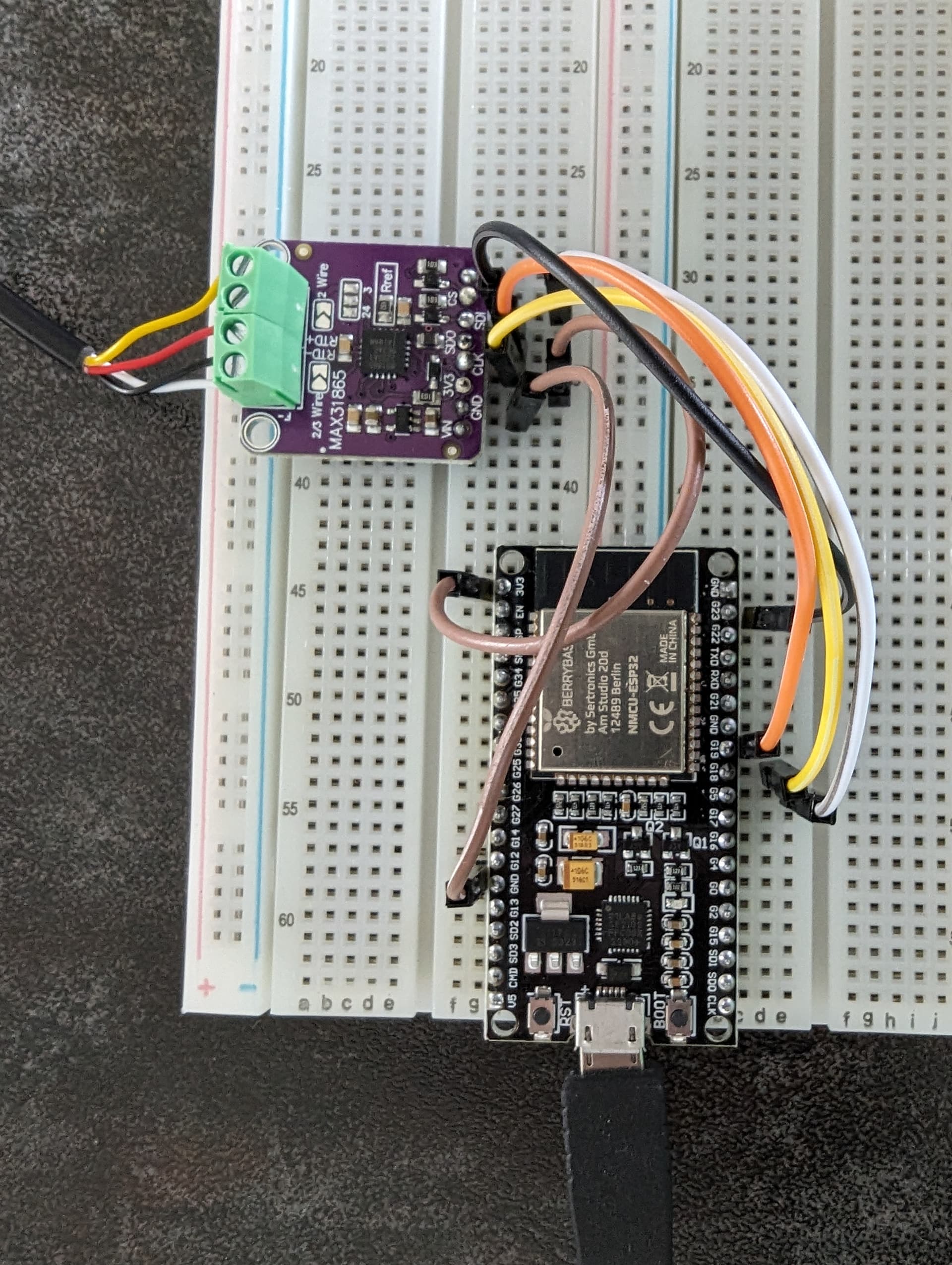

The issue: The temperature log displays temperatures which are a few degrees to high. For example boiling water has around 103 °C, cooled water with ice cubes around 6 °C, room temperature around 28 °C instead of 24 °C. So it is pretty close, but somewhat a few degrees too high.
I have tested another PT1000 from a different vendor, same issue.
Any ideas what is wrong here?

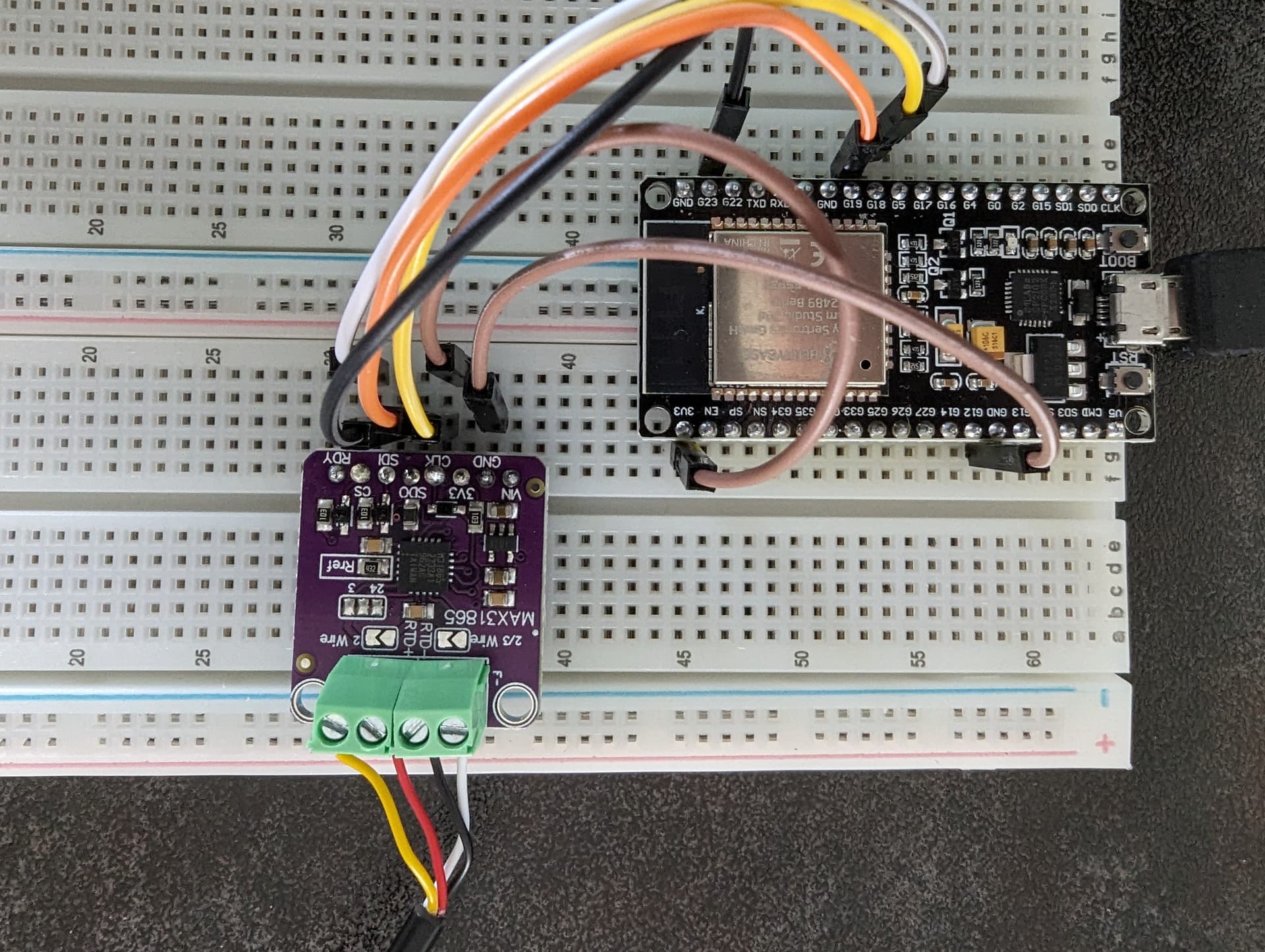

I am using:
- ESP32 development board (https://www.berrybase.de/esp32-nodemcu-development-board)
- PT1000 Class AA, 4 cable (black/white: + + ; yellow/red: - -)
- MAX31865 with RREF 432
Connection:
ESP32 --> MAX31865
GND --> GND
3V3 --> 3V3
G5 --> CS
G18 --> CLK
G19 --> SDO
G23 --> SDI

I have added some pictures as well.
