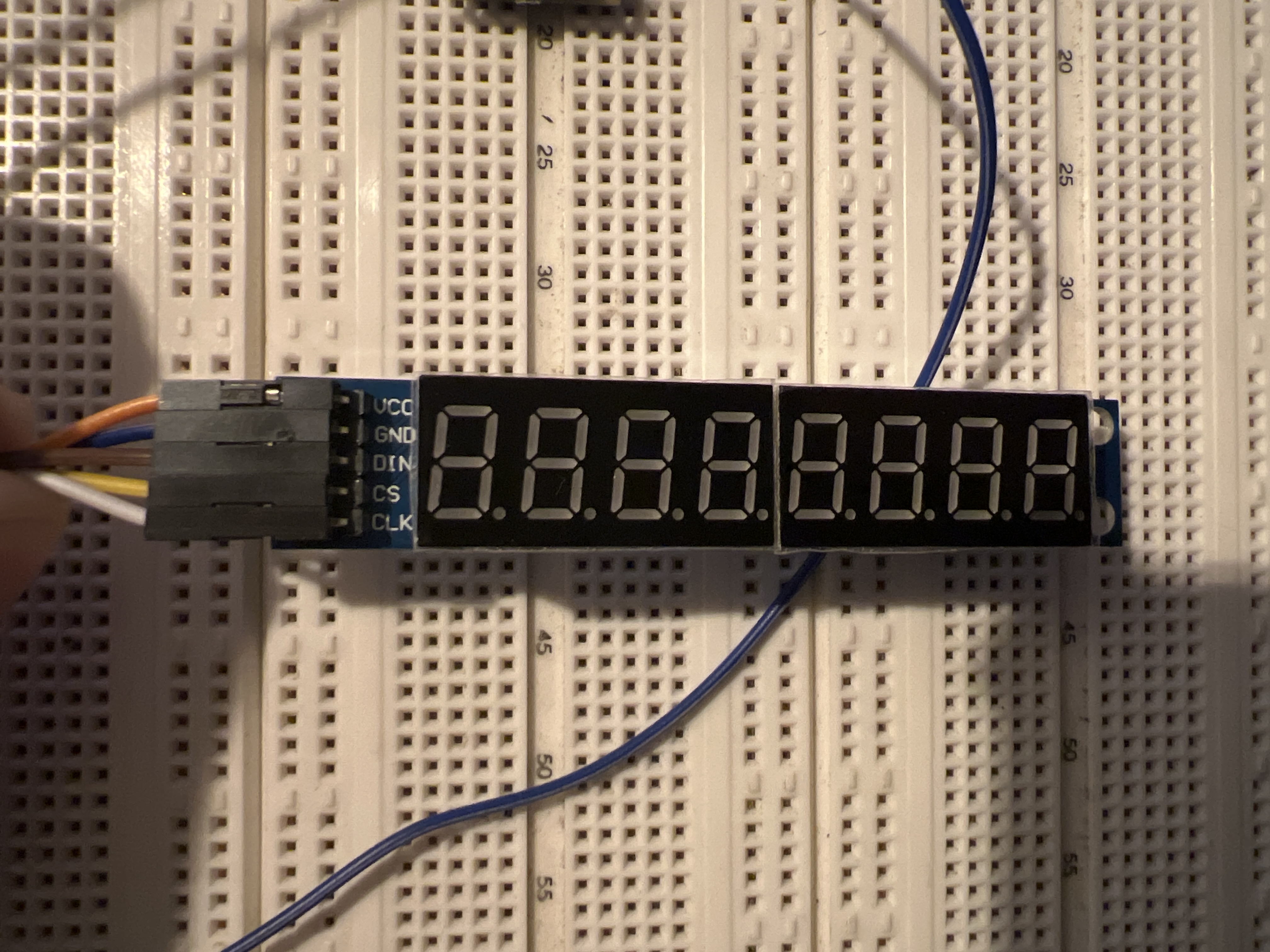

After messing with them, I could get all the segments to light up when plugged in, but couldn't get any actual readout. I'm using the LedControl library, and demo code which I posted below. I've tried different pins, no luck. After reading the reviews for these displays, I figured maybe they were just low quality. May people complaining of issues, not working, stopped working. The MAX7219 chip on the display is blank and reviews are calling it questionable.
So I bought these displays which have better reviews and actually have the part number printed on the chips: Amazon.com: HiLetgo 2pcs MAX7219 8-Digital Segment Digital LED Display Tube for Arduino 51/AVR/STM32 : Industrial & Scientific
My result were basically the same. The entire display will light up if rebooted, but I can't get any sort of readout.

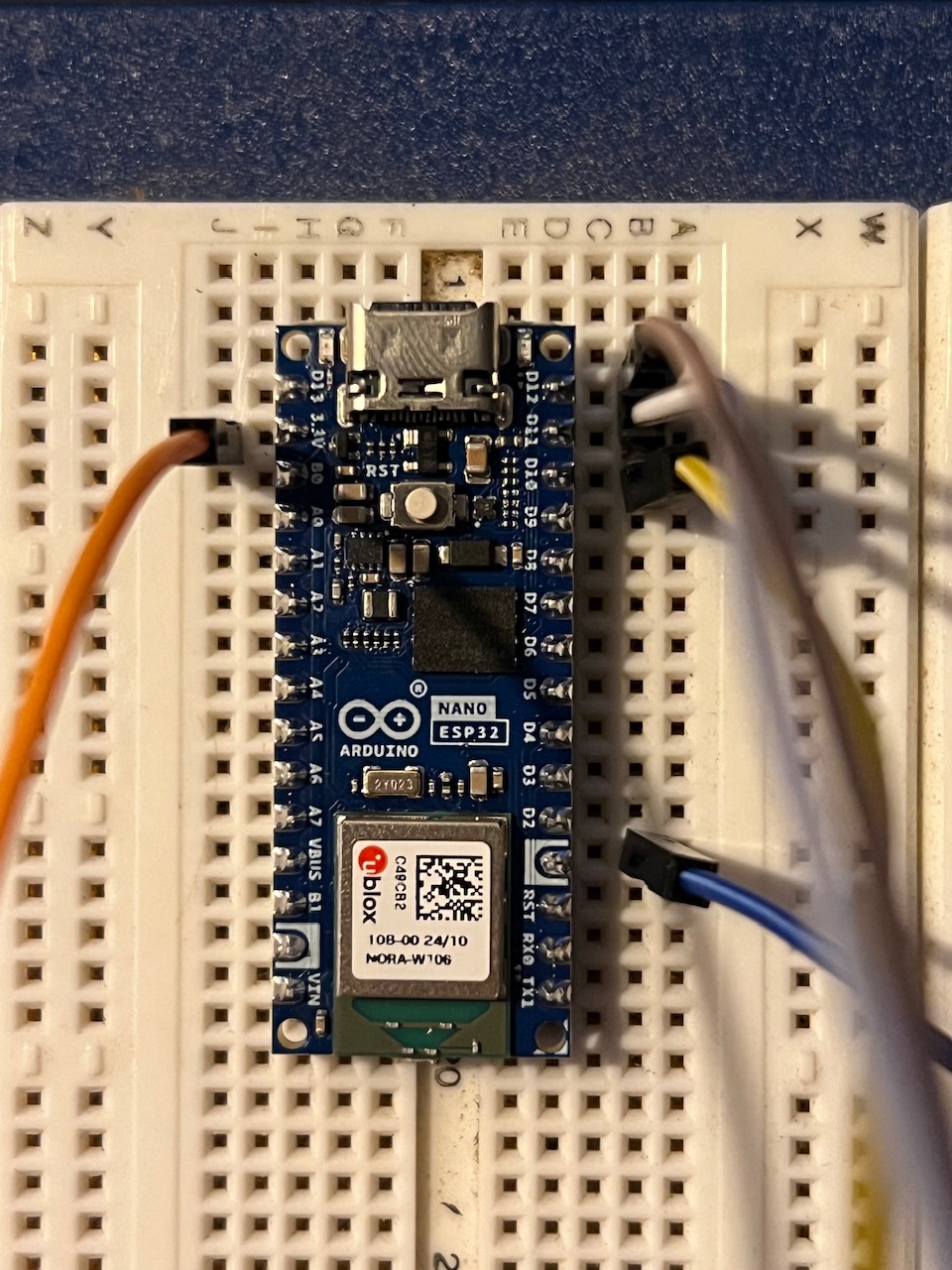

Other commenters say to check the connections. I've tried using a breadboard and M-F cables. I've tried F-F cables to connect the nano to the display. I've used short cables, longer cables. Nothing seems to make a difference. The nano is new and I've had success using it for other sensors and LEDs so far. But I'm struggling to get anything useful to display on them. So far I have 8 displays, and none are working as expected.
I'm using the pin out in the demo code which is included with the LedControl library, it's unmodified.
pin 12 is connected to the DataIn <--> DIN on the display
pin 11 is connected to the CLK <--> CLK on the display
pin 10 is connected to LOAD <--> CS on the display
I've tried 5v and 3.3v power from the nano. I tried adding a 500ohm resistor to the datapin shown here:
I'm not sure what else to try at this point. Any tips would be appreciated!
